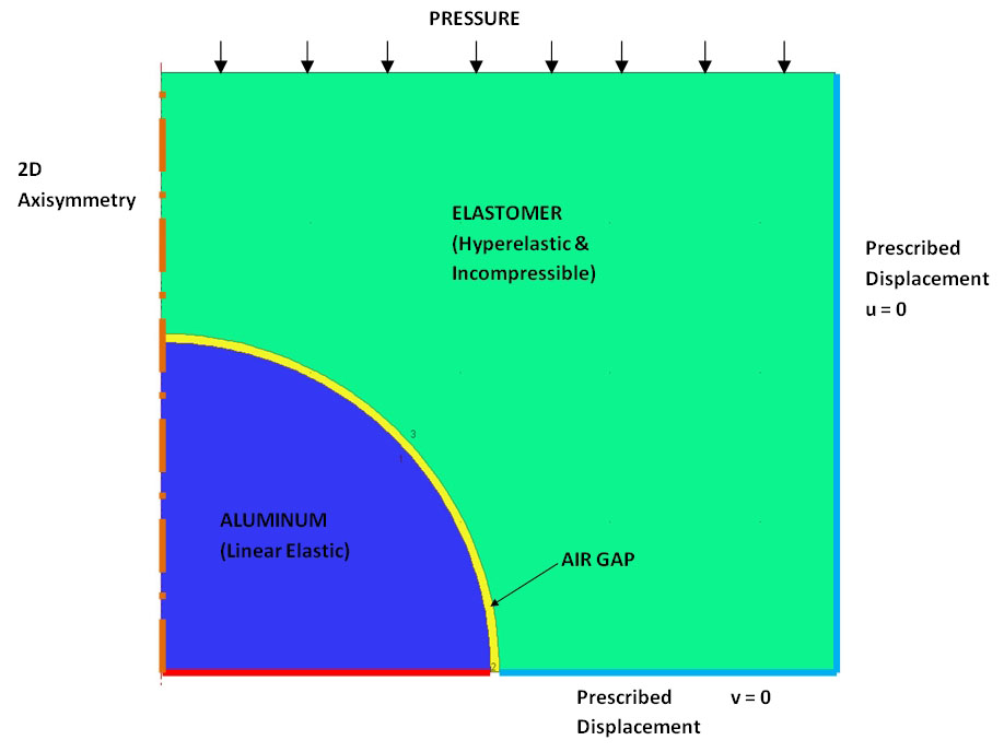

Hello everyone,
I would like your comments regarding the simulation I'm trying to do.
(See Schematic in attachment).
- 2D axisymmetrical model;
- Pressure load over an elastomer moving over a fix aluminum hemisphere (both separated by an air gap);
Goal: To get the pressure distribution over the hemisphere (i.e. to simulate the movement of the elastomer contacting the hemisphere due to pressure load).
Reading from the forums, I tried to simulate in the way Ivar was suggesting: considering the air gap as a "gelly-solid" with very low resistance but still considered a solid in the Solid Mechanics study. I don't know if it is valid in my case since the "air gap" should end up being entirely crushed and replaced by the pressurized elastomer.
My questions are:
- The displacement of the elastomer should cover the gap and contact the aluminum hemisphere. How to I simulate this? Do I really need to use the ALE moving mesh for that purpose?
- I don't need to know what's happening in the "air gap". Is there a way to remove it from the simulation but still being able to get the elastomer contacting the hemisphere? (I tried to use a contact pair but my model didn't converge)
Any comments/recommendations on how I should jump-start this again would be greatly appreciated.
Thanks!
