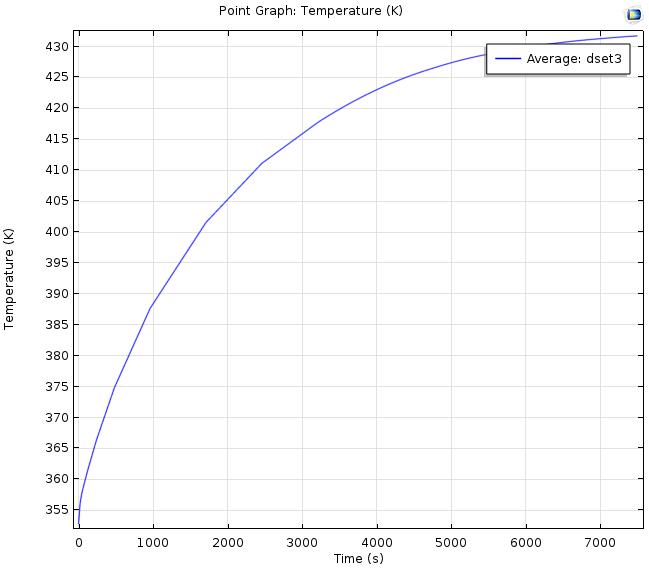

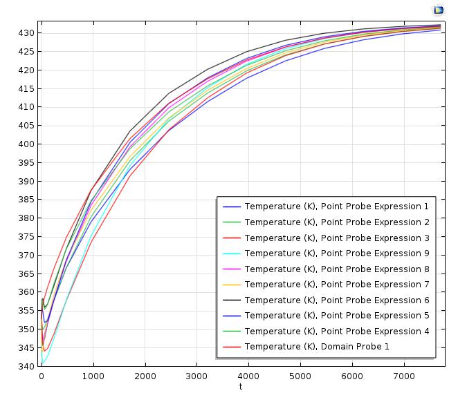

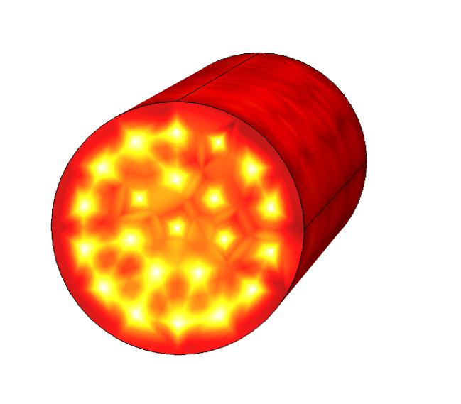

I am not sure what the issue is, please see attached file which shows the model and the expected results, which i have not made any changes to (which has no errors). The errors pop up when clicking compute. I have had to remove the solutions to be able to attach the file, i have attached the results that i was able to obtain previously. I hope to obtain temperature readings at the probe locations specified in the model.
