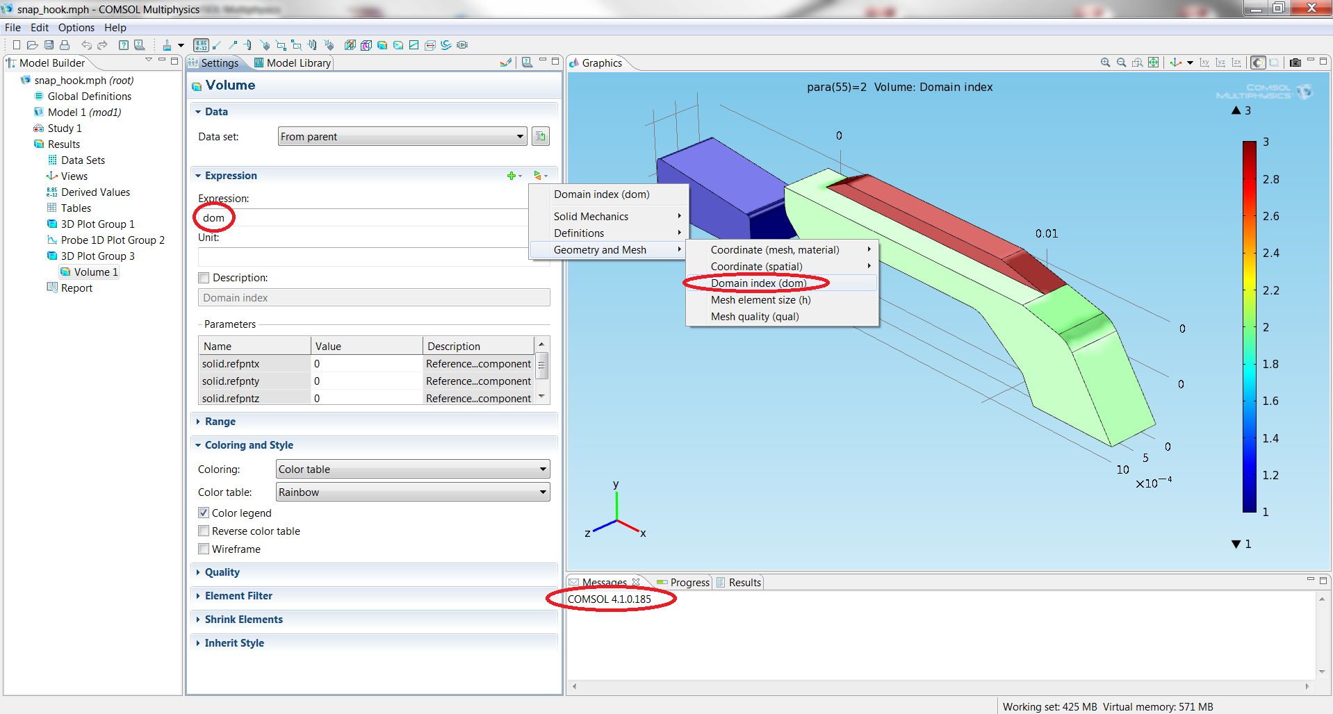

Hello Gentlemen,
In terms of coloring different domains in the Results node I can provide a quick solution (version 4.1.0.185). Have a look at the attached picture.
I hope this helps!
Zoran
Hello Gentlemen, In terms of coloring different domains in the Results node I can provide a quick solution (version 4.1.0.185). Have a look at the attached picture. I hope this helps! Best regards, Zoran

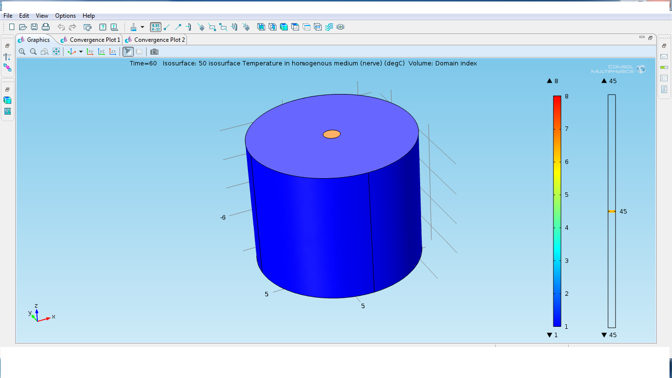

hi Ivar
i did the domain index as you explained, but i have a cylinder that surround the other domains in the model so i can't see the solution inside , i attache the photo of the result
could you told me how can i solve this problem
thanks a lot
hi Ivar i did the domain index as you explained, but i have a cylinder that surround the other domains in the model so i can't see the solution inside , i attache the photo of the result could you told me how can i solve this problem thanks a lot

Dear Basant,
In Results > Data Sets > Solution you can add a Selection node (right-click) and include only those domains that should be plotted. Attached image is a screenshot from version 4.3b.
I hope this helps!
Zoran
Dear Basant, In Results > Data Sets > Solution you can add a Selection node (right-click) and include only those domains that should be plotted. Attached image is a screenshot from version 4.3b. I hope this helps! Best regards, Zoran
