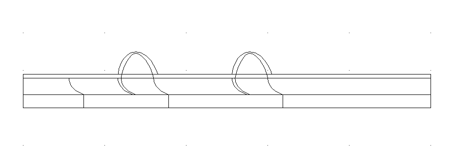

My model is about the single valve, the domain 4 8 9 13 15 is the solid membrane, when the flow enters from left to right, I need to find out how the membrane acts and how the fluids act.

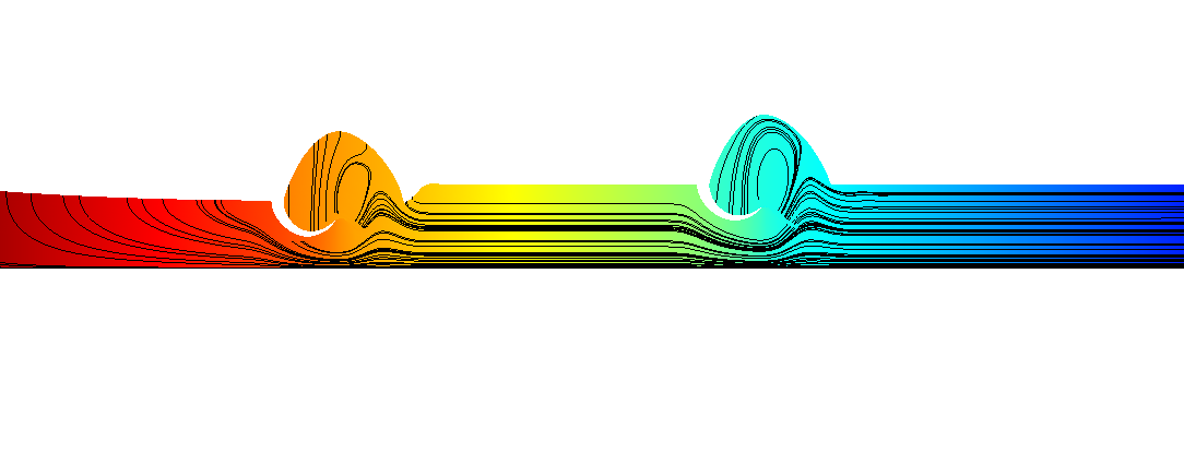

I attached some of my model pictures and the related behaviors of the fluids which is done in 3.5a
