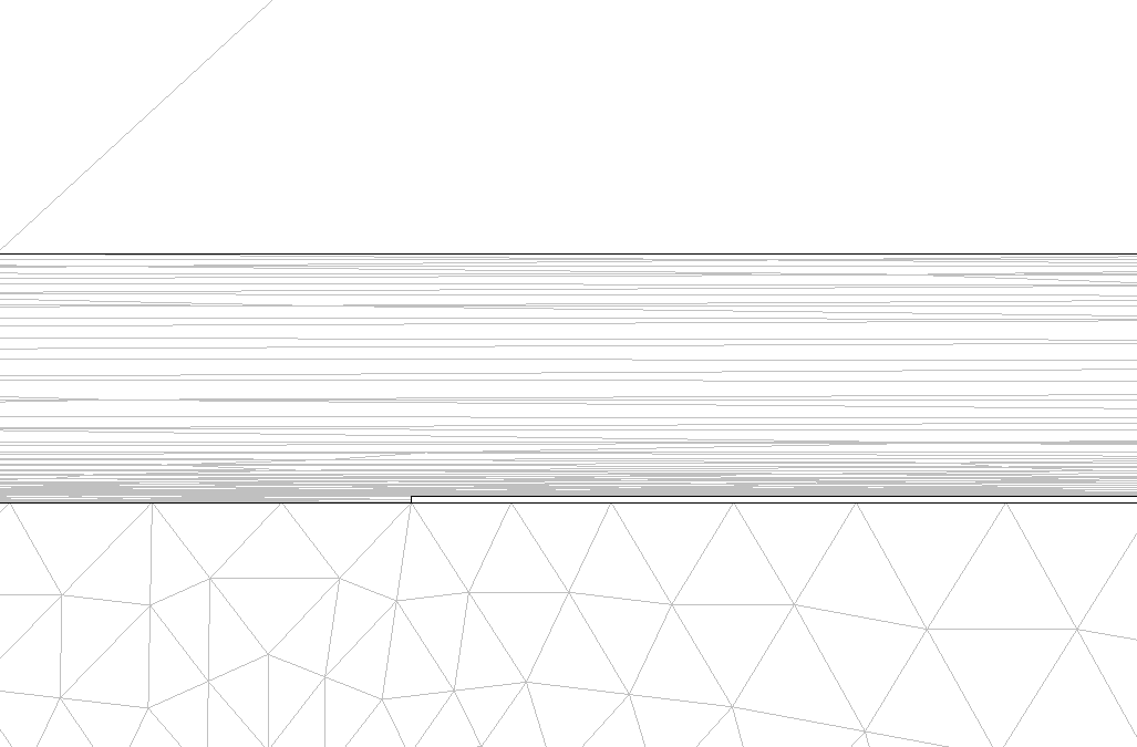

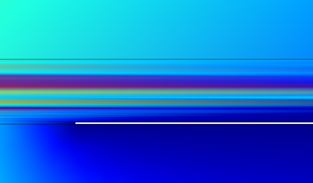

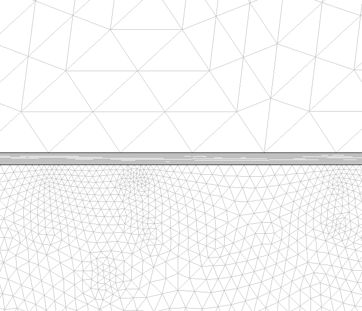

Hi all.
I'm trying to mesh a very thin film geometry.
x = 5000
y = 6
I set the x scaling factor from 0.025 to 0.0001 and get completely different results...
I see that the meshing in the thin film is kind of "sliced", there isn't many nodes in the x direction...
The results (electric potential) doesn't look right either.
Any suggestion?

meshing thin films is a very tricky issue, therefore COMSOL proposes ways to approache thin films by special boundary conditions. You can find these for thermal conductance, electric conductance, and as "shells" in the structural models. However this means that you must apply more physics and equations to your layers to emulate the desired effects. These approaches are rather well described in the documentation.
So I would propose to well identify your physical phenomena desired then to check the docs and try to use these special boundary layer tabs, rather than meshing them as volumes. Especialy if the model becomes somewhat complex.
But you might desire something not yet implemented, then you might manage to build your own equations on top of the standard system.
When I have to mesh such layers, i fight mostly with the free mesh parameters tab and trying out different "advanced" scaling features.
Hi meshing thin films is a very tricky issue, therefore COMSOL proposes ways to approache thin films by special boundary conditions. You can find these for thermal conductance, electric conductance, and as "shells" in the structural models. However this means that you must apply more physics and equations to your layers to emulate the desired effects. These approaches are rather well described in the documentation. So I would propose to well identify your physical phenomena desired then to check the docs and try to use these special boundary layer tabs, rather than meshing them as volumes. Especialy if the model becomes somewhat complex. But you might desire something not yet implemented, then you might manage to build your own equations on top of the standard system. When I have to mesh such layers, i fight mostly with the free mesh parameters tab and trying out different "advanced" scaling features. Good luck Ivar
