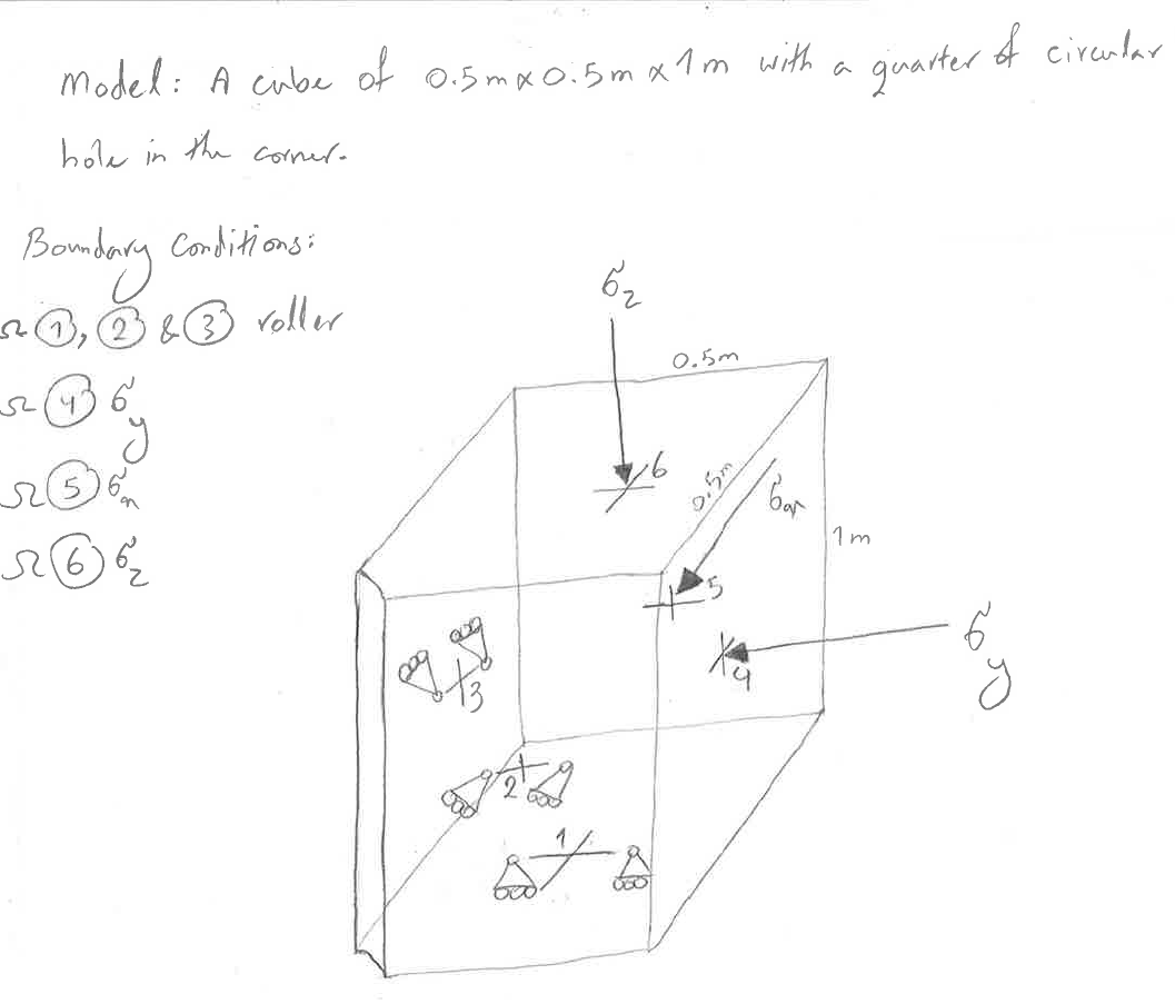

I am running a linear anisotropic model in 3D using solid mechanics module (Please find the geometry and boundary conditions in the attached photo). I would like to rotate the compliance matrix components at a certain angle. Here, I have several questions to raise:
