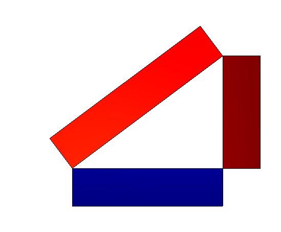

I agree NaN is not as I would expected either, If I take the model case HT Tutorail Model Cavity Radiation, there is no NaN in the File Export Postprocessed data, neiter for the subdomains, nor for the boundaries.
Hi I agree NaN is not as I would expected either, If I take the model case HT Tutorail Model Cavity Radiation, there is no NaN in the File Export Postprocessed data, neiter for the subdomains, nor for the boundaries. Ivar

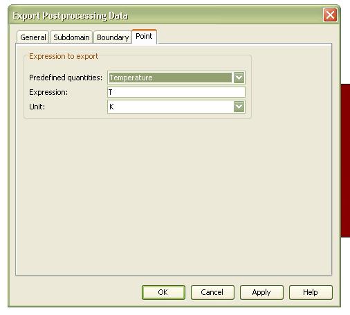

Thank you so much for your answer. I tried HT Tutorial Model Cavity Radiation and I received some of them “NaN”. I tried in other computer and still I received “NaN”. I am using Comsol3.3a. Do you think this version have some bugs? I attached some pictures also. Thank you for your help and time.

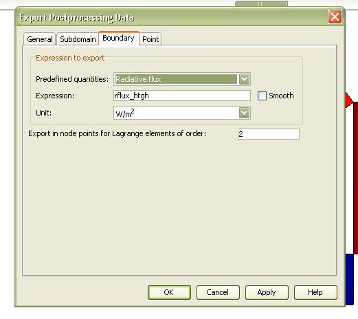

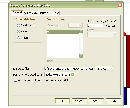

The process I am following is:
1) Run the model
2) File -> Export-> PostProcessing Data
3) Then I select Boundaries from “Export Data From” section
4) From Boundary submenu, I select
a. Predefined quantities : Radiative flux
b. Expression : rflux_htgh
c. Unit : W/m2
Serap

I'm running V3.5a,
I agree I get about 300 times NaN for the radiation flux, but when you check their coordinates you see they are the exteriour boundaries, not those inside the cavity.
Therefore I expect them to be NaN as they are not defined as "radiative", would'nt you too ?
Hi I'm running V3.5a, I agree I get about 300 times NaN for the radiation flux, but when you check their coordinates you see they are the exteriour boundaries, not those inside the cavity. Therefore I expect them to be NaN as they are not defined as "radiative", would'nt you too ? Good luck Ivar
