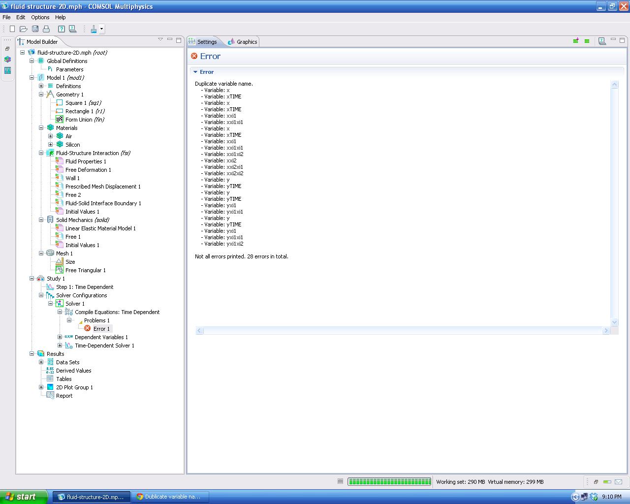

I am getting a duplicate variable name error (see attached). Any help is very much appreciated.

it's most probably because you have FSI which contains "structural solid" physics and "Solid" physics in the same model. You are duplicating many features, and if you do not use different dependent variable names you might get "duplicated names" error. Still the names on the list are puzzling, they are coordinates and not dependent variables.
Anyhow, with FSI normally you do not need to add solid, as its already contained in FSI, under subsection Structural
Hi it's most probably because you have FSI which contains "structural solid" physics and "Solid" physics in the same model. You are duplicating many features, and if you do not use different dependent variable names you might get "duplicated names" error. Still the names on the list are puzzling, they are coordinates and not dependent variables. Anyhow, with FSI normally you do not need to add solid, as its already contained in FSI, under subsection Structural -- Good luck Ivar

I've decided to just use FSI. Now I get this error : "Failed to create temporary file on server." Any ideas?

Thank you! I have fixed that problem. I am getting an error saying "Detail: mod1.fsi.vWallx, mod1.fsi.vWally." Yet I filled in all that was asked for. Any advice would be very much appreciated.

that means you have chosen turbulent mode and use wall variables, and something is not well set up, take a closer look on the main physics node of the fluid solid interface
Hi that means you have chosen turbulent mode and use wall variables, and something is not well set up, take a closer look on the main physics node of the fluid solid interface -- Good luck Ivar

Hmm, I selected "None" for "Turbulence Model Type" and everything else looks okay. I selected both the fluid and solid domains in the FSI's main node, but it does not allow me to select the boundaries under "Fluid-Structure Interface Boundary," labeling all of them as "not applicable." What to make of this?

Hi, in FSI you have a main node for all domains (fluid + solid) and then you have two sub nodes, one for the fluid only and one for the solid (you might need to add one of these two manually, it might not be there by default). Then you "wall" is set up as default for the I/F boundaries between the fluid and solid. You may add several nodes and also the same nodes, if you have different materials or physics to apply, on the boundary nodes ^some are additive some are exclusive (check the icons and the doc)
An entity (domain or boundary) that is tagged "(overridden)" has simply been redefined by another node further own the tree model. An Entity tagged "(not applicable)" does not fit the physics selected or is not related to the specific physics.
one need to get used to this chaining and potential overriding of properties, but it is very handy for multiple cases studies. one can add or disable a later node and change the simulation case simply and rapidly. In next release I hope COMSOL manages to have these disable/enable also driven by the different solver selected
Hi, in FSI you have a main node for all domains (fluid + solid) and then you have two sub nodes, one for the fluid only and one for the solid (you might need to add one of these two manually, it might not be there by default). Then you "wall" is set up as default for the I/F boundaries between the fluid and solid. You may add several nodes and also the same nodes, if you have different materials or physics to apply, on the boundary nodes ^some are additive some are exclusive (check the icons and the doc) An entity (domain or boundary) that is tagged "(overridden)" has simply been redefined by another node further own the tree model. An Entity tagged "(not applicable)" does not fit the physics selected or is not related to the specific physics. one need to get used to this chaining and potential overriding of properties, but it is very handy for multiple cases studies. one can add or disable a later node and change the simulation case simply and rapidly. In next release I hope COMSOL manages to have these disable/enable also driven by the different solver selected -- Good luck Ivar

COMSOL automatically identifies the boundaries that form the fluid-solid interface. In the model both domains seem to be defined as fluids. A first step here is to add, for example, a Linear Elastic Material Model node to domain 2 to represent the solid. The boundary selection in the Fluid-Solid Interface Boundary node is then updated to include the four boundaries that separate the solid from the fluid.
Magnus Ringh, COMSOL
Hi, COMSOL automatically identifies the boundaries that form the fluid-solid interface. In the model both domains seem to be defined as fluids. A first step here is to add, for example, a Linear Elastic Material Model node to domain 2 to represent the solid. The boundary selection in the Fluid-Solid Interface Boundary node is then updated to include the four boundaries that separate the solid from the fluid. Best regards, Magnus Ringh, COMSOL
