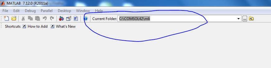

"using mphstart"
As Matt said rightly," Matlab doesn't know where to find the Comsol library of commands".
Firstly set your current folder to C:\COMSOL42\mli
In fact, mphstart is in "mli folder". Once you set and then type mphstart in command prompt, things will work..(make sure comsol server is ON before using mphstart)..
