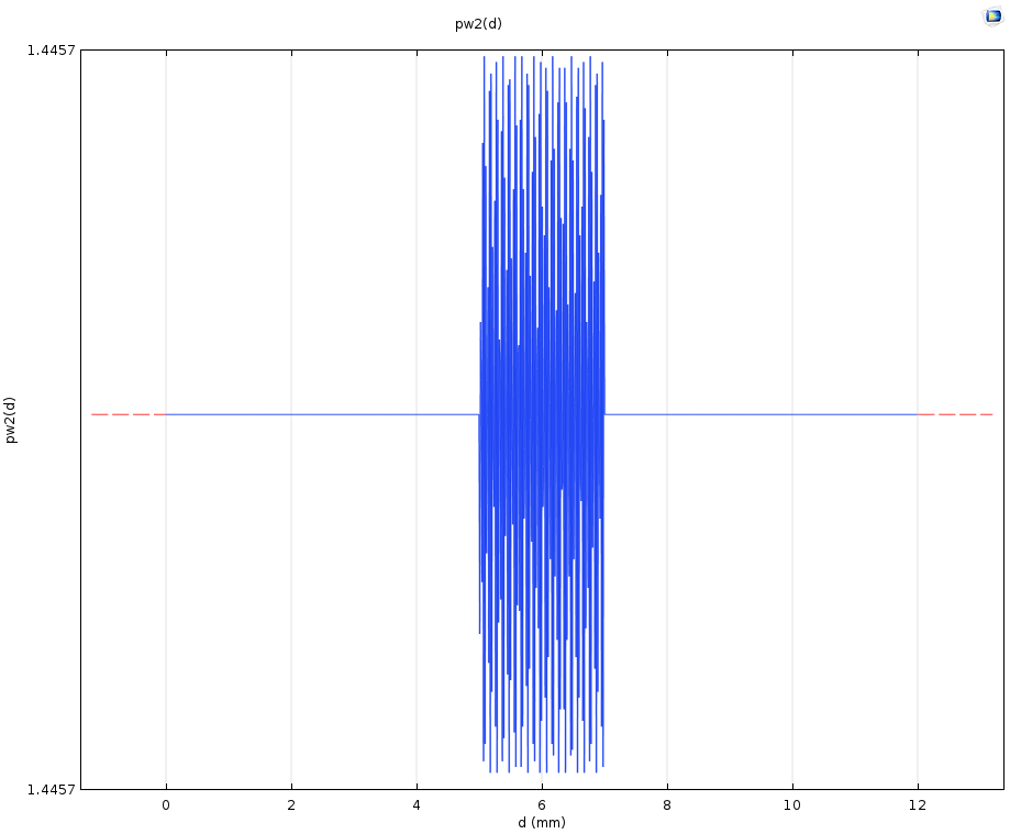

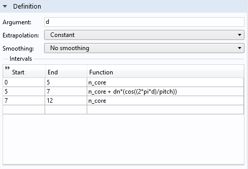

Right now, I am working on simulating a simple optical fiber, wherein a bragg grating is inscribed. Currently, I am using a piecewise function to modulate the refractive index of the core. Figure 1 shows a plot of the function used: At the beginning the refractive index equals some specified constant. After 5 mm the modulation starts. At 7 mm the refractive index is again constant. Figure 2 shows the definition of the function. The parameter n_core is simply a constant, dn is the "strength" of the modulation and equals , d is actually a "dummy" variable which should represent the space dependence along the z-direction. Unfortunately I was not able to figure out how to use the real global coordinate z as argument (maybe someone can help me with that too). The last parameter is the pitch, which has a value such that the reflected wavelength equals

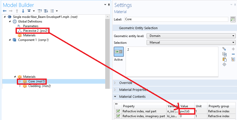

. Figure 3 shows how I tried to use that function as a material property for the core of the optical fiber.

Why does the defined function looks like as shown in figure 2? It seems like the amplitude is not the same after one period.
Is the way I have defined and used the material property (figure 3) correct?
If I want to have a unitless output from the function, is it enough to just ignore the "Function units", i. e. writing nothing in the corresponding field? Or do I have to type in something?
