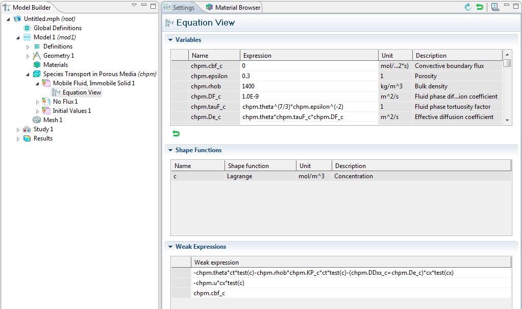

I'm modeling species transport in saturated porous media. My species transport equation includes:
- Time-dependent
- Convection
- Diffusion
- No adsorption
- No dispersion
If you look at the weak forms for a Mobile Fluid-Immobile Solid, you find (after having removed useless terms equal to 0):
-chpm.theta*ct*test(c)-chpm.De_c*cx*test(cx)-chpm.u*cx*test(c)
There should be a time derivative with the porosity in it: -c*chpm.thetat*test(c)
i.e. the second term in equation (3-107) in the Chemical Reaction Engineering Module User's Guide,
but it's not there! Anobody knows why?
I guess the assumption is that the porosity is considered constant, but it's not mentionned anywhere.

I'm running a transient analysis since the beginning, over and over. No transient term has appeared in the weak forms after simulation.
The transient term for the concentration (c) is present in the equation from the start: -chpm.theta*ct*test(c).
What I'm saying is that there should be a time derivative of the porosity in order to respect the equation in the User's Guide (see eq. 3-107 in the attached pdf). This derivative would have this form if we respect the default comsol nomenclature: -c*chpm.thetat*test(c)
with
c: concentration
chpm.theta: porosity
But this term is never there! As if the porosity was ALWAYS considered constant...which is wrong.

There should be TWO time derivatives: one for the concentration (c) and one for the porosity (chpm.theta).
Please look at eq.3-107 in the attached pdf of my second post.
I work in 1D.
Have a look at the weak espressions in the attached jpg here, and compare with eq. 3-107: the second time derivative is not there, as if porosity was considered constant.
No matter the value of the porosity (I tried many things: time dependent polynomial, etc.), the second time derivative never appears.
I'm running 4.1.0.185.
Hi, There should be TWO time derivatives: one for the concentration (c) and one for the porosity (chpm.theta). Please look at eq.3-107 in the attached pdf of my second post. I work in 1D. Have a look at the weak espressions in the attached jpg here, and compare with eq. 3-107: the second time derivative is not there, as if porosity was considered constant. No matter the value of the porosity (I tried many things: time dependent polynomial, etc.), the second time derivative never appears. I'm running 4.1.0.185.
