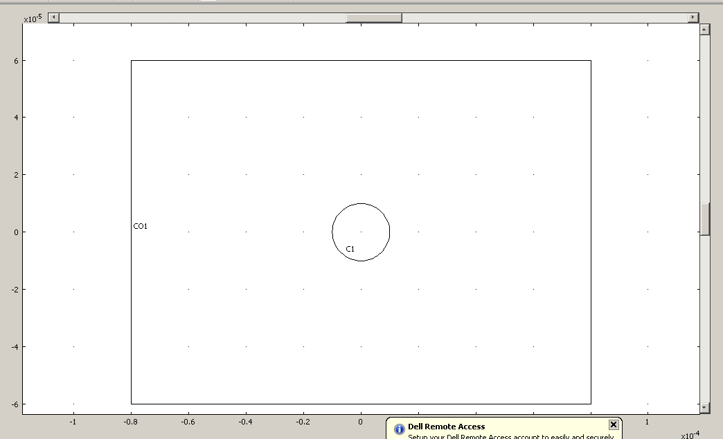

I’m trying to use the material model library in order to model the blood inside the capillary blood vessel (until now, I’ve modeled the capillary as a hole which had a load [pa] on the boundary to represent blood pressure).
For start, I’ve decided to use the water (liquid) from the liquid library. After doing that, I intend to add blood as a material to the fluid material library.
In the subdomain settings I’ve chosen water and than defined heperelastic material (I’m not sure about that but I thought it’s the best from the options there…) , nearly incompressible material , and set values for initial shear and bulk modulus…
In the boundaries settings I’m defining a load of 4300Pa (Fn=-4300). My model is solved, but when I’m plotting the pressure, I get that in the capillary I have a pressure of about 582.7 pa… what am I doing wrong?
My model is 160 ,icron in length, 120 micron un height and I’ve defined a thickness of 150 micron…
Also, I’ve noticed that in the subdomain settings I can define pressure in the init tab, should I use that to model the blood pressure as well? I’ve tried to use that… but my model doesn’t converge than… I receive the error:
Error:
Failed to find a solution:
No convergence, even when using the minimum damping factor.
Returned solution has not converged.
I must say that I’ve tried to use the init tab alone, and tried to use it while modeling the boundary load simultaneously… and in both cases received the error…
Should I use the init tab for pressure?
Finally, when I decide to add blood to the fluid material library, Comsol will aggnolidge it as a fluid , right?
Thanks,
Yael
If I read you right you are saying you use water instead of blood, that I can follow (I belive blood is about 92% water, pls check), as a first approximation it's a decent start, then you choose/state hyperelastic, there I do not follow.
2 recommendations:
1a) when using the material library be sure you use the right material a given material can appear several times, and that the one choosen has all the required properties, use the show "all" tab, and select "hide undefined properties", for me these should be the default mode (COMSOL developpers have decided otherwise), then verify that you have chosen the correct phase (i.e. liquid, gas, solid ...) and orientation if applicable.
1b) Then check that the proerties are there, and that they are valid within the desired T and p (temperature and pressure) domain you intend to us for your model (or watever other variable).
1c) select OK and when back in the subdomain window select the appropriate material setting and be sure you have all required variables IN BOLD, as BOLD means this is read-in from the library (you might want to override some values or to complete some other missing, this will appear as normal text), check the units if OK.
1d) Then be sure that all new variables (required by the material data) exist and are defined in your model, such as T, p etc (for some Tempref too), if not set them as constants, "red" units is typically an alert about such a case, I mostly start all my models with 3 constants predefined:
T 20[degC] "ambient temperature"
p 1[atm] "ambient pressure"
G 1[lbf/lb] "gravity acceleration"
2) when you select a material property, be sure you fully understand it, know its definition and applicability, if you have any doubt, have a look at the documentation, i.e. search for hyperelastic in the smeUG.pdf doc, i.e. p120 V3.5a you will see a sentence such as:
"...material models for modeling nearly incompressible hyperelastic materials such as rubber...."
so I would not use hyperelastic for water, anyhow if you look at the Material properties, you see several are in normal text, and are left at default values i.e those of steel or copper or... depending on the application mode selected. If you are interested in the thermal properties of water, I would be sure I have at least heat capacity, heat conduction and density in BOLD, for fluidics, you need in addition the viscuosity.
Furthermore, water as a fluid canot be modelled correctly with the structural application modes such as the smps, smpn ..., you need the Navier-Stokes application ch... for the fluid, and then link this to the structural parts, or you must rewrite some of the equations in there to make them "fluid compatible", the latter would anyhow not be the way I would recommend.
Now for your case, in 2D do you really need the water meshed as a volume ?
I would say no, at least to start with, leave an empty cavity for your "big" blood vessel(s), and apply the pressure directly on the vessel valls/boundaries, where you also model the heat exchange via "h" in [W/m^2/K] (correcting then the units for the default 1[m] depth of a 2D model), and the temperaure of the blod, being the Tinf variable, or via Q and the bioheat equation for a blood vessel boundary or something like
h[W/m^2/K]=rho[kg/m^3]*C[J/kg/K]*v[m/s]. where rho, C and v are the blood density, heat capacity and velocity.
To find reasonable "h" and or blod flow values you will have to look it up, or I can recommend that you get hand on the recent book of Ashim Datta: "Modelling Transport Processes, Applications to Biomedical Systems", you will find most relevant material data and more therein.
Note: use the standard bioheat equation for the irrigated muscle subdomain
As you say, you have also a "p" and "T" (in fact NOT "T" but "Temp_smpn" and "Tempref_smpn" !) that can be defined, for the sme application modes (SMPN as I'm, describing here above), by the "Subomain Settings Load tab" and then selecting, "include initial pressure", and "include thermal expansion", which will add a few physical elements, such as pressure depending on the thermal expansion etc
To understand what this means: look at the changes of "Variables" tab under "Physics - Subdomain settings" this is where COMSOL updates the equations governing the physics for the application mode, depending what you add in the GUI's.
Note also that if you change these load settings, you might have to reapply your library material, as this changes some of the names, check the BOLD text on the Material, if its still there !).
This seems perhaps complex, but once you think really over it, it's rather logical, if you add/replace some new physics and variable names, you might have to update other parts if your model too, so as usual with a nice piece of hardware or software: do not play with the buttons if you do not really know what thay are for;)
or rather, read and re-read the books first.
Finally I agree, I talked about hyperleastic material earlier, but I was referring to the muscle/fat that for me is more like rubber, not the blood, sorry for that confusion. Now if you want to see, in addition to the temperature distribution a compression of the muscle due to the blood pressure from the main blood vessel you need the material properties for muscle/fat, again there I'm not sure where to find those. If you define them as hyperelastic you need the appropriate parameters, I'm not sure finally if this proposal was the best, but I neither know any equivalent E, nu for muscle.
Perhaps we should give google a try
Hope this helps, a little on the way
the thread is getting long, rereading number 1 up there I notice that I was refering just above to the SMP.. modules, while you probably are not using that one at all, only the bioheat (htbh) module which should be enough to do a thermal analysis.
I got confused with the refernce to hyperelastic which is structural material property as well as pressure which again leads me to structural or fluidics. If you want to see the effect of the pressure variation of the blood flow, you need the structural model too for the muscle.
Apart from that, most wat I said earlier should be still relevant for you.
Thank you once again for your detailed reply! You are of great help to me! ?
Reading your answer I have realized I haven’t given enough details, I will try to correct this.
I’m using plane strain (smpn) and bioheat (htbh) modulus. My muscle is defined as a hyperelastic neo-hookean material, with the values of initial shear modulo, bulk modulus, etc… as I find in literature. In the bioheat modulo I have also defined all the properties of the muscle and blood (heat capacity, density, etc…) as found in literature. The convection coefficient was indeed evaluated in the way you have mentioned.
I must say I was rather disappointed to read in your reply that “, water as a fluid canot be modelled correctly with the structural application” and that I need Navier-Stokes application… I don’t want to use Navier-Stokes application because I don’t want to define blood velocity… I thought that by using the model library I can select a material that will fit well with the modulu I am currently using…
Well, indeed at first I’ve modeled my capillaries (which are in the diameter of 10 microns) as a hole in the tissue, and applies a load on the boundary to represent blood pressure. I must add that I’m applying displacement on the upper boundary of my muscle (upper boundary of the rectangle) , as I want to see the deformation. At first I’m modeling a displacement in the x direction; the next step will be to add a y displacement also.
The reason I wanted to add a material to the capillary “hole” was:
1. I thought this will be more exact, then I could also see the stress distribution in the capillary subdomain.
2. as I am coupling the bioheat modulo as well, solving for the thermal map I get the temperature in the muscle, but the capillary still appear as a hole.
However, those matters are not critical issues, just thought it will be nice to have… ?
I know that blood (or water) is not a hyperelastic material (blood is viscoelastic). But after I’ve added water from the fluid material library (I have done the 1a-1d steps you suggested, properties defined in the library for water as liquid are: heat capacity, dynamic and kinematic viscosity, density and thermal conductivity, clicking on the “function” button I have seen that the properties are dependant on temperature and they fit my model) I’ve noticed that the subdomain settings for the material model weren’t changed (besides the density which was taken from the model library and appeared in bold), the material was selected by comsol as default as isotropic with default values of E, etc… as were already in there before the loading of water material from the library… this is why I thought of changing those values and settings…
Well, I guess that if I need to add the Navier-Stokes application, I’ll better leave my capillaries as holes and use the structural modulo alone…
Yael.
Well then I hadnt forgotten everything, good.
Now were I do not agree is when you propose:
"1. I thought this will be more exact"
Using physics on a boundary is not "less exact", provided that your physics is correct and describe all (most)properties involved.
An incompressible liquid as water has no shape, hence whatever is applied on one wall containing some water is distributed uniformly on the others, your vessel section will not change except due to the thermal expansion difference of water from a temperature change, but for a body these temperature changes are minime and the thermal expansion of water is small.
At least for me pressure on the wall is plenty to describe what happens in the blood vessel in 2D.
Once you go further into the details, one would need a better 3D model with the fluid and its velocity along Z, then the visuosity of the blood would also be needed, and normally the velocity distribution of the fluid in the vessel, which is not uniform, rather parabolic with about 0 velocity strictly on the borders.
This means on the other hand that the formula for h=rho*C*v is supposing a perfect heat transfer wall-liquide and is a "best" case.
The corrective factor for "h" would also depend somewhat on the vessel diameter, the heat conduction and the transverse velocity of the liquide (still neglecting turbulence), as if the conduction is high, the transverse velocity low and the diameter small, the temperature gradient across the liquide can be neglected, and we have a better heat transfer from wall to liquide.
A radial scaling value "a" can be obtained from:
a[m]=k[W/m/K] / (Cp[J/kg/K] * rho[kg/m^3] * vz[m/s])
where k is the heat conduction, Cp the heat capacity, rho the density and vz the transverse velocity of the liquide
Finally, the bioheat equation is basically considering all this by assuming an uniform capillary density for a given volume of body material.
Further, when you go one step further into the details, one would see Venturi effects from the blood flow and its pressure variations of the hart beats, fighting against capilary collaps, but for this I believe you need a 3D model, and such 3D models are very heavy: hours to solve and dozens of GB RAM required.
One way out would perhaps be to push further 3D flow physics on the 2D edge boundary.
In conclusion quite some physics from many domain to apply, true "multi-physics" here
Have fun
PS from next week on I'm back at work, so I will have far less time to follow the forum
Guess I better stick to 2D with the load on the capillary boundaries… :)
Thank you again for your help, I appreciate it so much.
Hope you are enjoining your time away from work,
Happy New Year,
Yael
