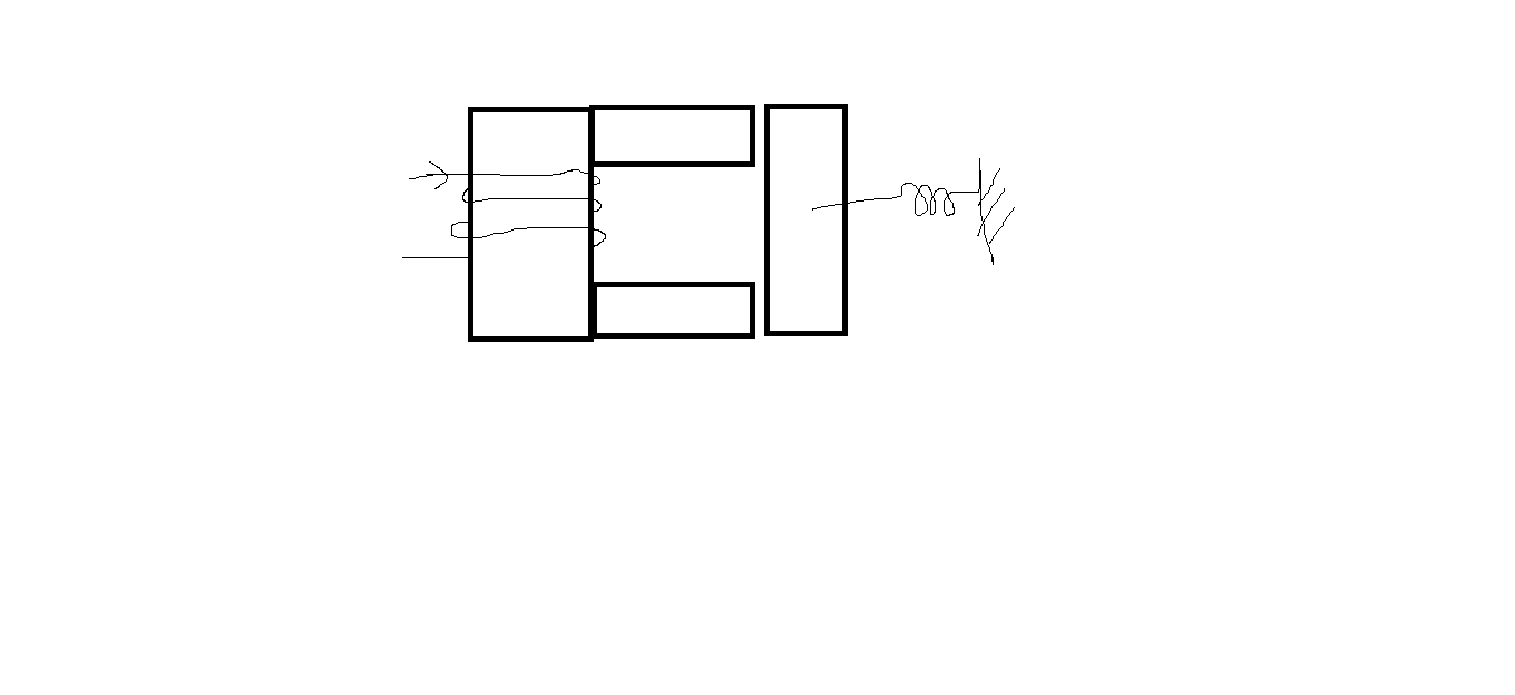

I tried to simulate a structure similar to that of a transformer in which an inductor is wound over a iron core with an iron gap. I have attached the structure image for your perusal. When ever I use stationary solver I dont have any trouble. But coming to Time Dependent solver, I changed the coil nature to Multi-turn coil-Numeric as well as changed the source to Sine source.
