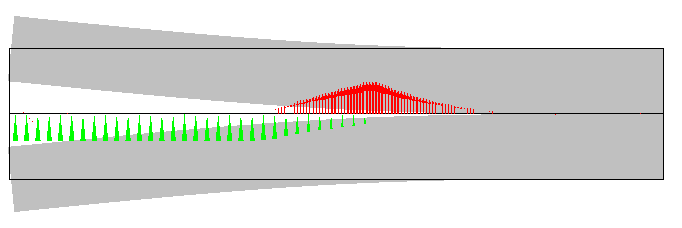

Hi Stefan,
I have uploaded a simple 2D model (version 4.3b) illustrating the principles of how a cohesive zone can be modeled in COMSOL Multiphysics. The model is not solved, but it only takes a minute or so to do it (and the animation during solving is nice).
Important features are:
- The expression in the thin elastic layer and the constitutive function it references.
- The extra weak expressions added for keeping track of the maximum opening experienced in a certain point. This is not necessary in a case where there is no unloading but then the constitutive relation would have to be written in a different (simpler) way too.
- The setup of the solver steps.
The uploaded plot shows the stress distribution (red) and a damage parameter (green).
The model is run under prescribed displacement. The reaction force plot shows why this is necessary. The released energy during cracking/delamination is so large that it would be unstable under a prescribed load.
Henrik
