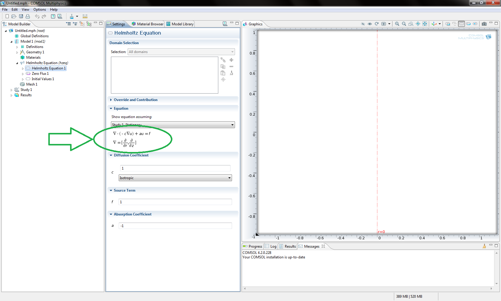

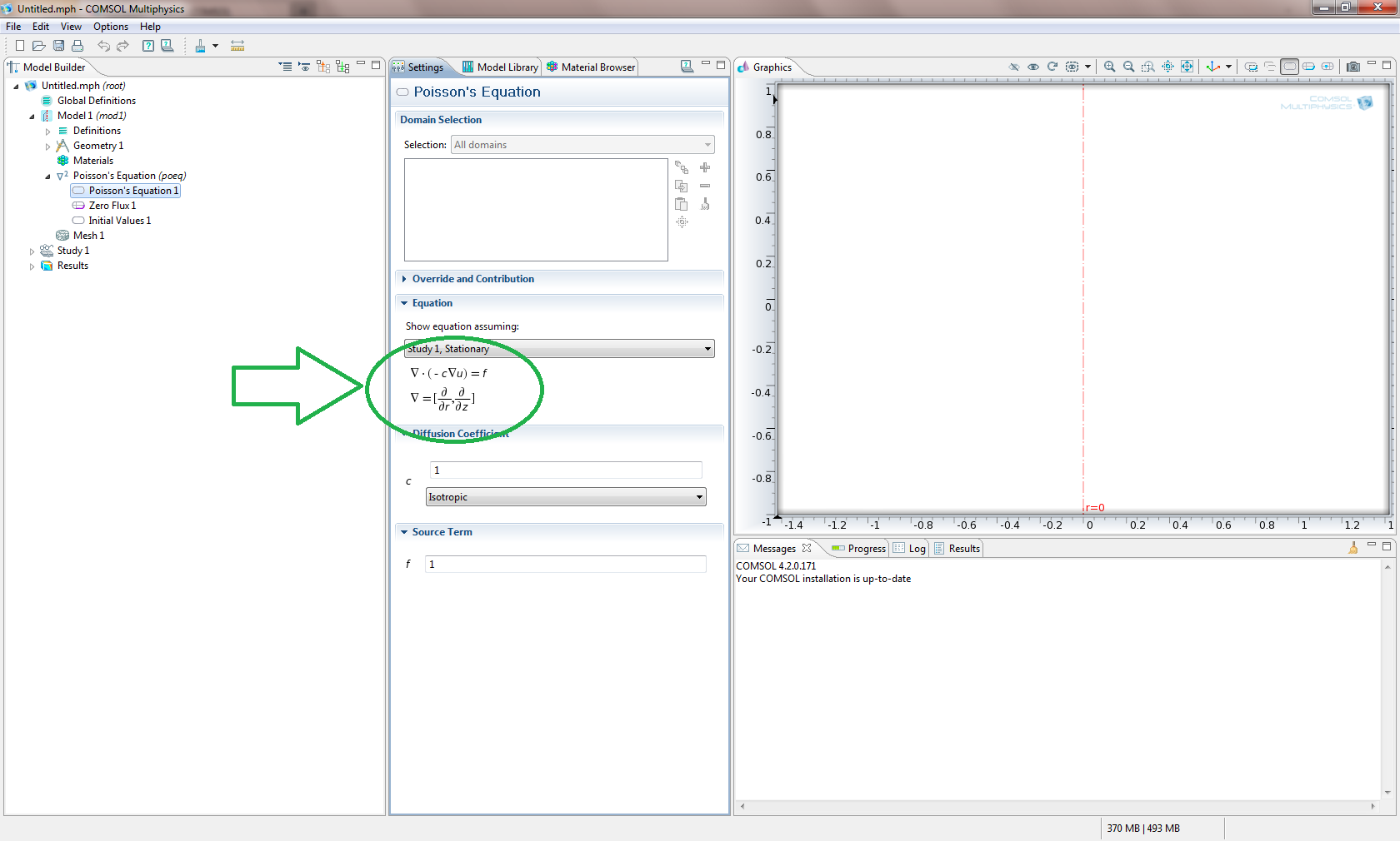

Posted: 1 decade ago 10.06.2011, 11:14 MESZ
as a new user I am quite disappointed:
The geometry of the model can be defined as 2D axisymmetric, but when I add the PDE for Poissons equation to it (via PDE (poeq), the equation is not adapted to the geometry?
Which coordinate system is used in the equation? On the drawing/Geometry r and z is used, but it is not clear to me whether the equation is based on a cartesian system x,y,z , or on r,phi,z ?
How is the div (divergence) operator in cartesian and axisymmetric coordinates written in Comsol?
Thanks,
junis

Posted: 1 decade ago 10.06.2011, 16:15 MESZ
For Poisson in a 2D axisymmetric case, you can see the equation in the Equation section of the Settings window: it tells you that the software solves \nabla . ( c \nabla u) = f with \nabla defined as (d/dr ; d/dz ). See attached screenshot.

d/dtheta (er) = etheta
so etheta*d/detheta (er) = 1
If \nabla defined as (d/dr ; d/dz ) then we will miss a term in an axisymmetric system when calculating \nabla . ( c \nabla u) = f
for c=1 it should be: d^2/dr^2 (u)+ (1/r)d/dr (u)+ d^2/dz^2 (u)
and not this: d^2/dr^2 (u) + d^2/dz^2 (u)
Can you please clarify on this...
Note: er, etheta and ez are unit vectors in the respective direction.
This is not complete information. In cylindrical coordinate system d/dtheta (er) = etheta so etheta*d/detheta (er) = 1 If \nabla defined as (d/dr ; d/dz ) then we will miss a term in an axisymmetric system when calculating \nabla . ( c \nabla u) = f for c=1 it should be: d^2/dr^2 (u)+ (1/r)d/dr (u)+ d^2/dz^2 (u) and not this: d^2/dr^2 (u) + d^2/dz^2 (u) Can you please clarify on this... Note: er, etheta and ez are unit vectors in the respective direction.
