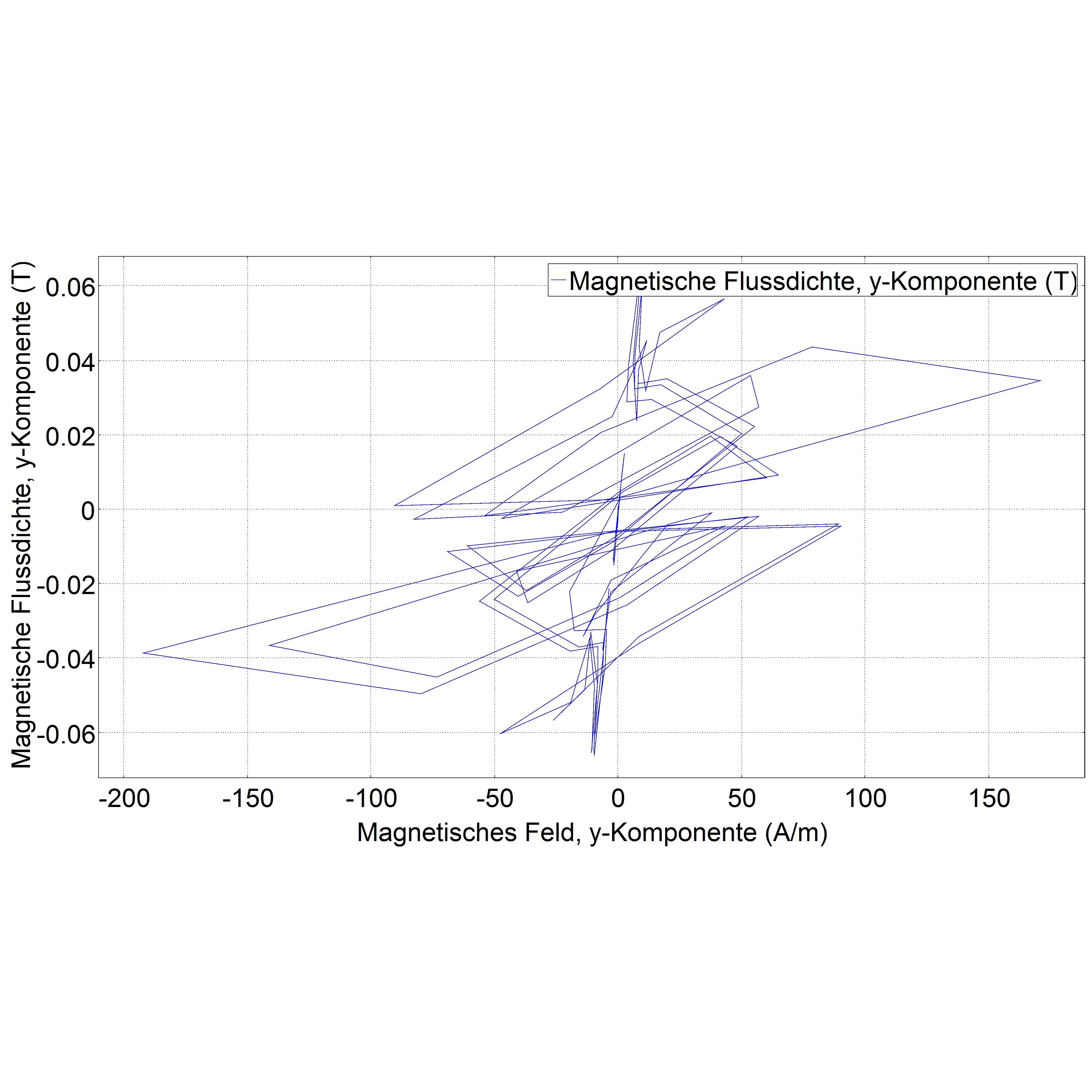

Hi All,
i desperately try to evaluating hysteresis loss in comsol way. there are a few commonly used formulas.
i think, the easiest is to measure the area enclosed by the hysteresis loop in a cycle Ahyst
Ph= f * integral [ H * dB ] --> but how about sekundare Loop ? see the attachment (hysteresis on the stator tooth)
there are two most common models Jiles-Atherton (JA) and Preisach model (PM)
to use JA parameters alpha, M, a, k and c should be identified for example bei conduct an experiment
PM is mathematical model of hystereses (very mathematic). i have difficulty to understand it and implement it in comsol.
-Steinmetz-Model (SM)
Phy/V = k * f^alpha * B^ß

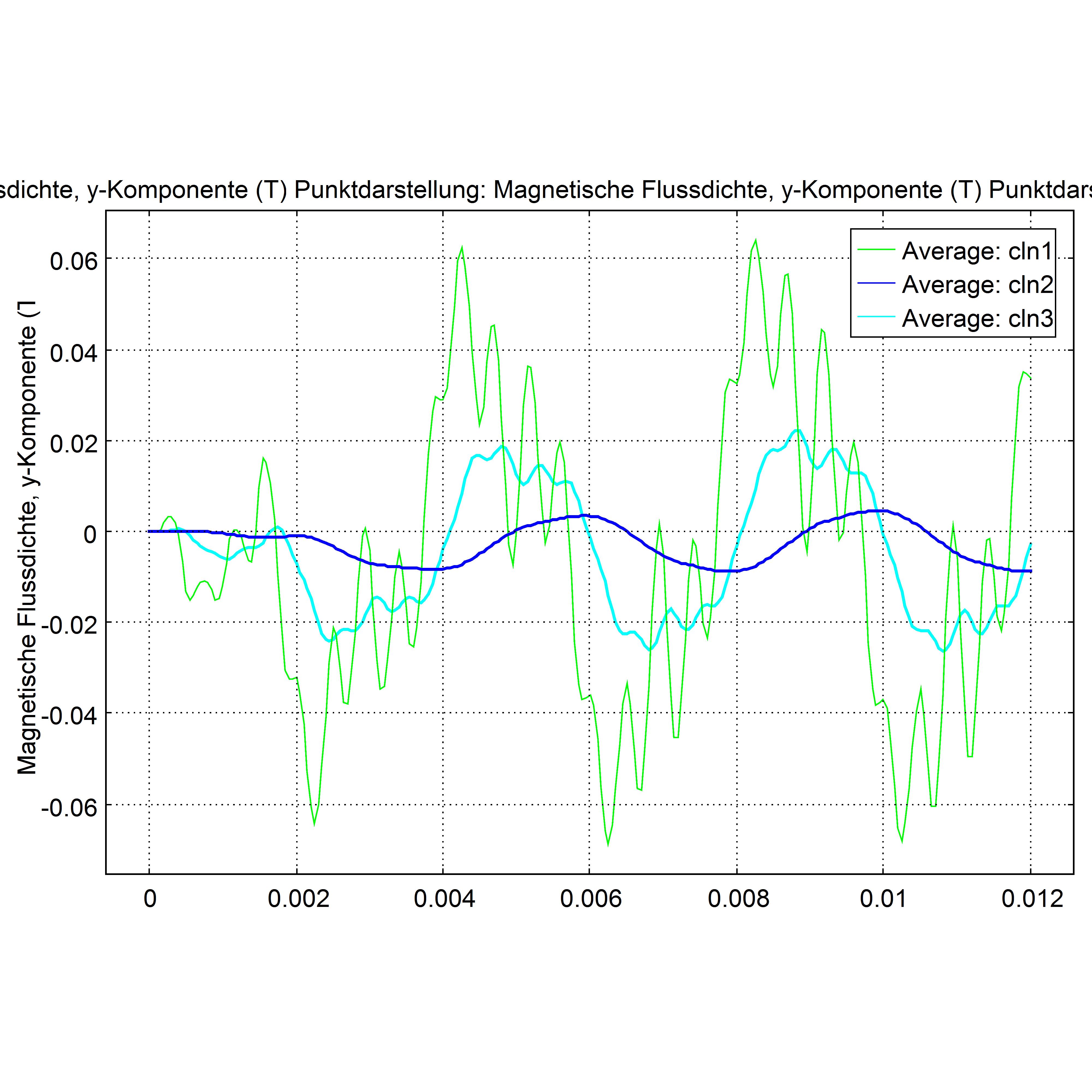

this SM is more for pure periodich flux. k and ß can be calculate using PM. see B-curve (green line)
I have non-lin HB-Curve of the Softiron.
What is the best (accuracy, simple) way to evaluate hysteresis loss?
thank you in advance!
regards
akmal

Hi All,
i got the curve of one periode of magnetizing in B vs H.
The BH Area could be caculated in primitiv way. comsol has rmm.Wm calculated. by using photoshop i can evaluate the relation (c=Ahyst/Amax) between closed loop area and the maximal area of B*H (instead of rmm.Wm).
Whyst [J/m³] = c * Wmax
Physt [W]= Whys * freq * Volume
any comments are welcome.
regards
akmal

Hi All,
thx for your suggestion. have also consider separate modell only to evaluate hysteresis loss. B and H curve on stator tooth can be applied in model also. i'll try to share the modell only for hysteresis losses soon.
"If you use the coil current and the coil voltage to calculate the electrical power in both cases the difference between the analyses should be the hysteresis losses, right?"
No, the difference is not only hysteresis loss but also eddy current loss (induced current in the soft iron).
To Daniel Harburg, tell me about your model. it is a rotating machine or something else?
regards
akmal
