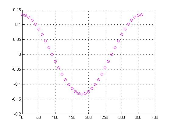

my inquiry is regarding the validation of FE solution. i have the analytical solution of the potential distribution on the surface of a sphere of radius 0.1m having a dipole in the center with source (current) and sink 0.005 m apart from the center of the sphere. the closed form analytical solution,attached, based on "Electric Potential by Two Point Current Sources in a Homogeneous Conducting Sphere" by ERNEST FRANK produces max potential of 0.1329 and min potential of -.1329 volts. which i have also confirmed from "An Improved Method for Localizing Electric Brain Dipoles" 's analytical solution.
when i compare those analytical solutions with the solution generated by FEMlab there is a huge disparity. the femlab file is attached. the V max and V min extracted by femlab are 8.909e-3 volts and -0.0265e-3 volts, respectively.
i do not understand as why there is such a big difference.
