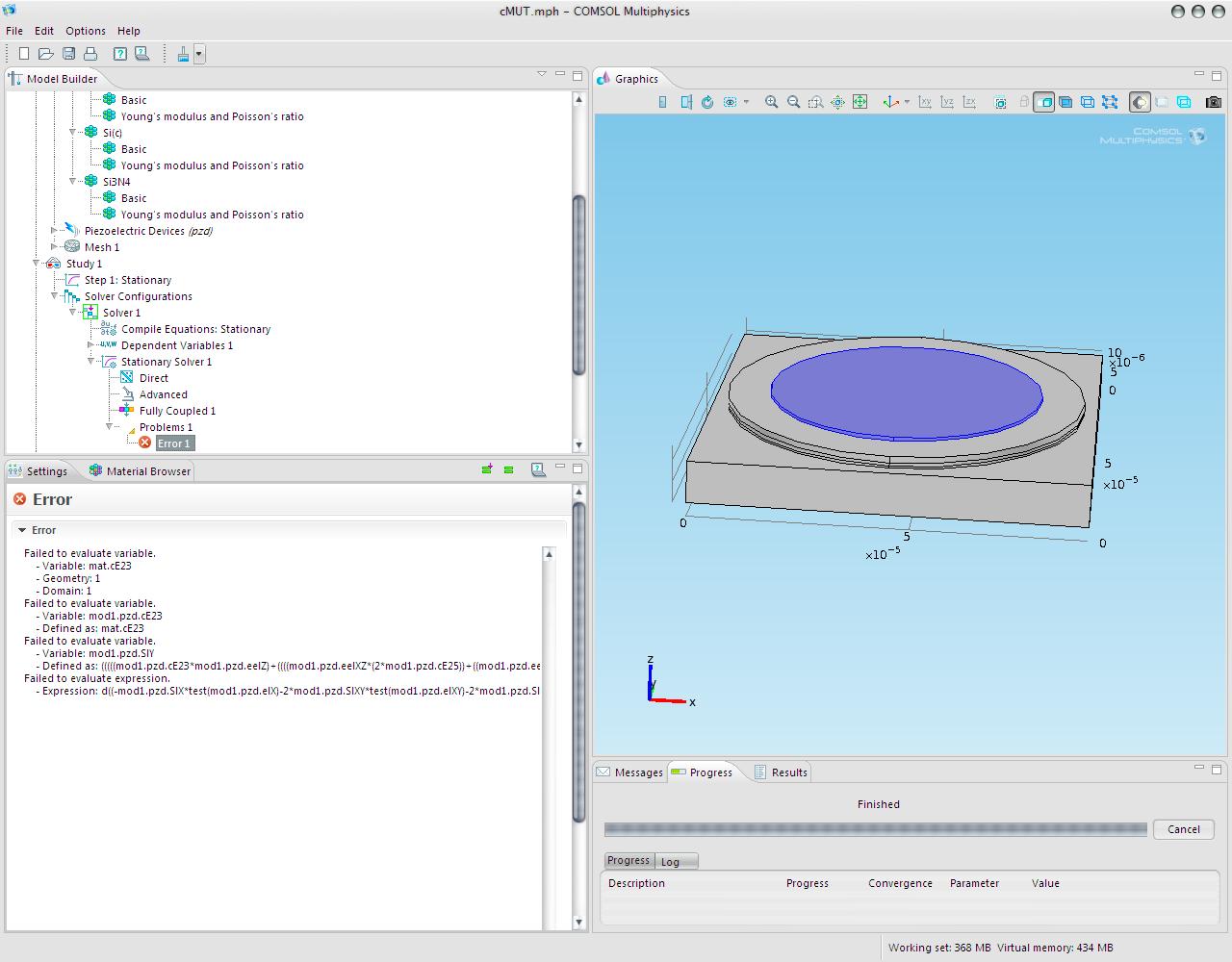

comsol error Failed to evaluate variable.
I have this error, see the attached file.
Can any one help me quickly, please ?
Thanks.

you must provide more information. These error messages are not very instructive. You can upload your model so forum members can have a look and try to find errors.

Thanks for you, this is the work file
and in the first post the print screen image.
i want any one help me in solving this error, to complete my graduation project.
Thanks.
[QUOTE] Hi, you must provide more information. These error messages are not very instructive. You can upload your model so forum members can have a look and try to find errors. Cheers Edgar [/QUOTE] Thanks for you, this is the work file and in the first post the print screen image. i want any one help me in solving this error, to complete my graduation project. Thanks.
Posted: 1 decade ago 27.06.2011, 16:54 MESZ
I had a quick look and there are some errors:
All your domains are in the piezoelectric material study node, but probably not all are piezoelectric.
You don't have the piezoelectric material parameters in your materials. See the red buttons in the top 3 lines of the material contents.
So move the non-piezoelectric domains into a linear elastic (?) node and provide the piezoelectric material parameters for the remaining piezoelectric domain(s).
There may be more errors but I suggest to fix those most obvious ones and see what happens.
Cheers
Edgar

Thank you very much
now only one error
Variables not coupled to any degrees of freedom.
- Detail: mod1.V
the file is attached
i insert all domain to Linear Elastic material, but i don't understand why ?
Thanks
I'll wait your replay.

if you moved ALL domains into linear elastic, then the piezoelectric node is empty and that might be the reason for the error.
You must keep the piezoelectric domain in in the piezoelectricity node and provide the required material constants, i.e. the elasticity matrix, the coupling matrix and permittivity.

i don't understand each physics , so when i want to design >> can't select the right physics to work with
i will try again and tell you, Thanks,
