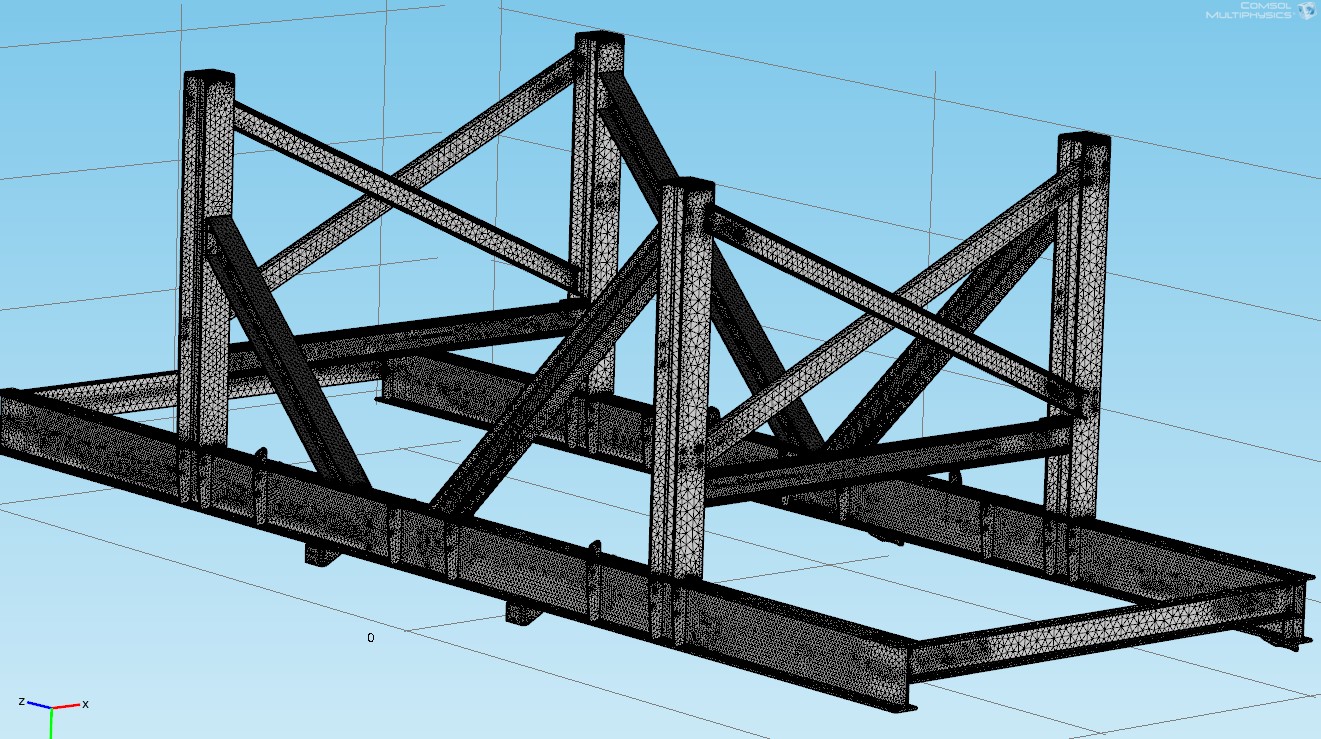

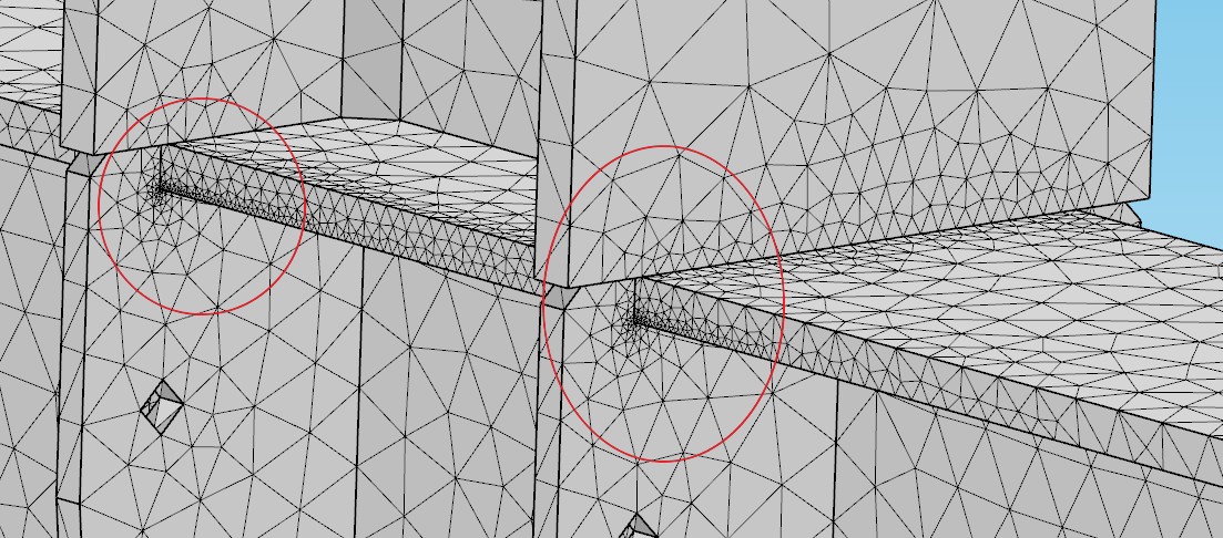

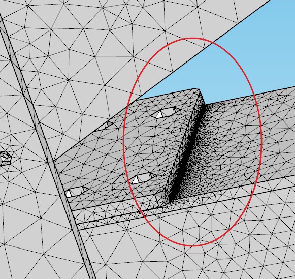

I took a look at your file. I did a default mesh. While it did not mesh to calculate a solution, what it did come up with is that the number of elements was 549,000 or so. That is quite a bit. You will need a 64bit computer with decent RAM for that amount of elements. I also noticed in the mesh (see images) that you have a lot of little elements. Now it may be that when you export the file from your CAD program it is adding a bunch of things that you do not need. There are holes in your structure that maybe you do not need. You could remove those (unless they are critical to your analysis). When building models use only what you need because adding other things can make the mesh difficult and too intense. In the second image file, I have circled a couple areas where the mesh is dense. I can also see curved areas in the geometry that maybe don't need to be. It is just that these little things add up. The image 'mesh3' shows a very dense area. Even though comsol is importing it fine there may be areas in the geometry where sides are not attached together completely that was done by the CAD pkg. COMSOL likes it when everything lines up mathematically correct and will do odd things when you are off by very little amounts. I have seen things not mesh well because I either had a thin area or two elements were off by fractions of mm.
