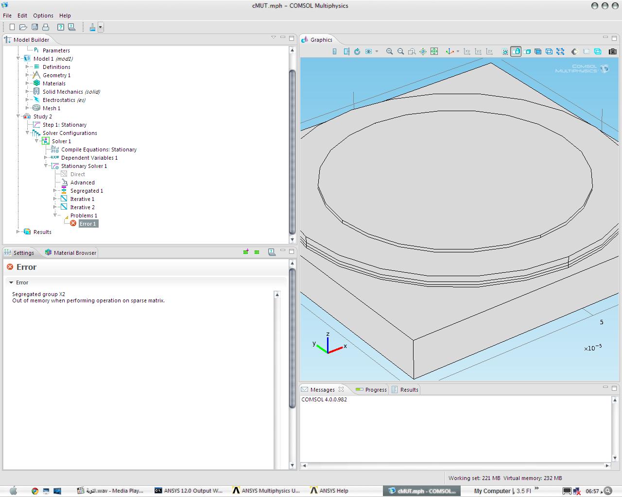

Hi, I'am Mohamed Aref and model cMUT and after each simulation of my model this error occur
So what is the solution of this error ?

See the attached files, please

Your mesh generates to many elements and you don't have enough memory to run the calculations on all of them, so the solver stops. You either need a computer with more ram, or you need to coarse your mesh, and even switch to a 2D resolution if you can
