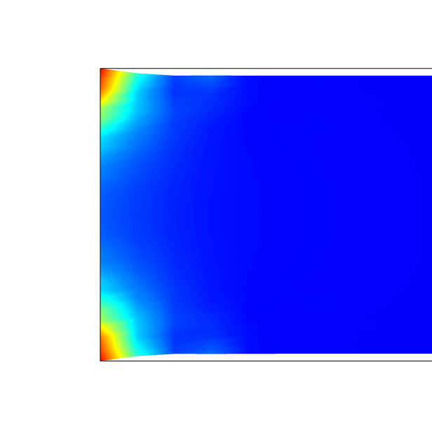

1: If you look at the attached picture, you can see that the model is somehow fixed at the rotary axis. I already included the "rigid body movement suppession node". But...

It is difficult to guess, but maybe you have added Rigid Motion Suppression to more than one of the physics interfaces.

1: You was right. I had the "rigid motion suppr." node on every interface. This problem was solved very fast. Thanks for that.

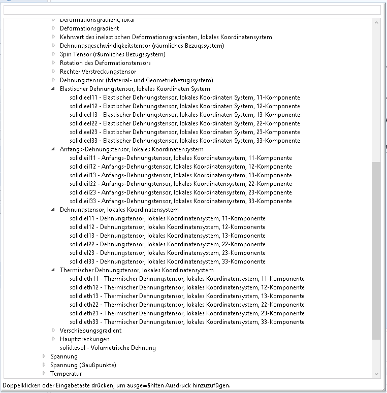

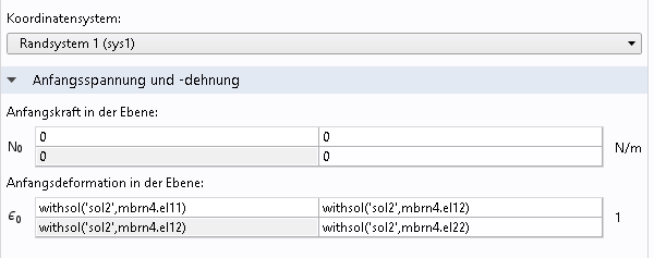

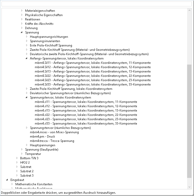

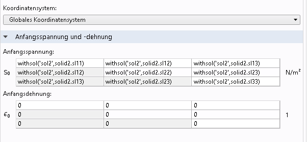

2: I choose the way with the several studies for each depositing step, so that each studie run´s through all previous interfaces too. So I build up the model for each solution- and "depositing"- step + the new layer. To the "already existing" layers and the substrat I added an "initial stressund strain" node. Every existing layer and substrat I pointet to the same layer at the previous solution regarding the stress or strain. But at this point I´m still struggeling a bit with the right operator synthax. The "initial stressund strain" node for solid and membrane is different. Especially for the membrane it´s a bit confusing. I´ve attached 2 pictures for solid and membranes. Additionally I attached 2 pictures of possible strain and stress tensor components. There are several possible tensors, but which one is appropriating? Sure I could try them all and take the one which gives me the best results, but i would like to understand there meaning. Altogether, the model runs, even if the results are not matching the measurements. But i guess it´s also a matter of a lot of material property assumptions.

I think you are on the right track. With regard to the strains to use, I believe you should use the elastic strains (mbrn.eel11 etc.). It is the elastic strain that is producing stress, so by "offsetting" using the elastic strain, you ensure a stress-free activation of a layer.
Good luck!
