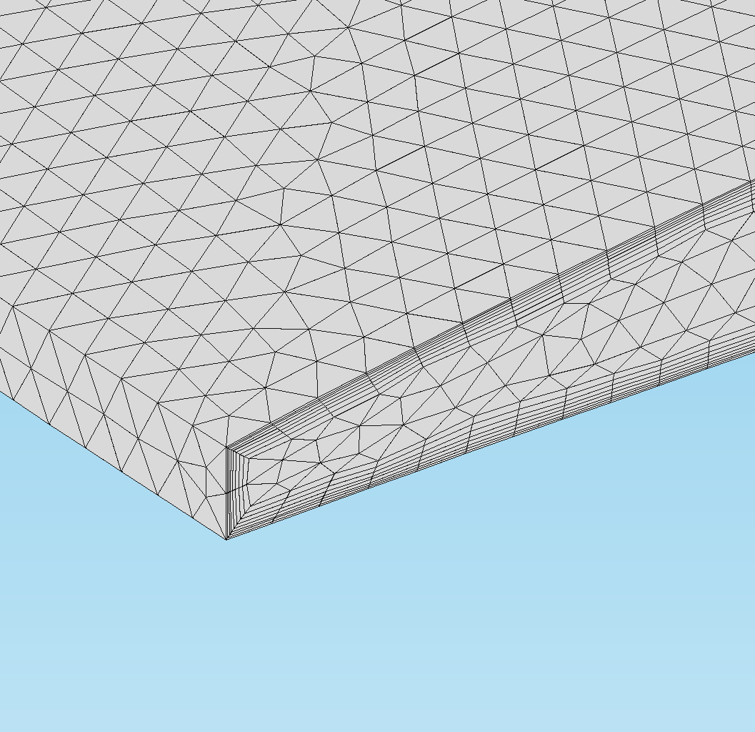

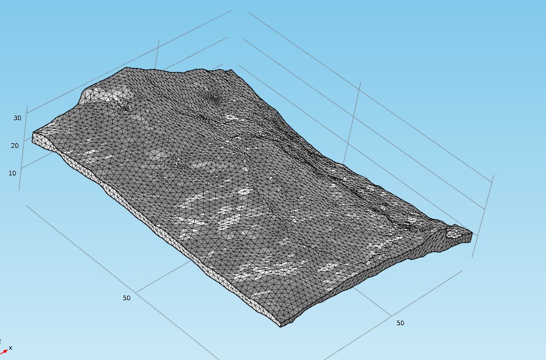

I opened your file and saw the mesh1 you had in there. When I meshed it, it came up with 622948 elements. That is a big problem to solve.
In the model, I added another mesh and just did a default free tet with default size. It meshed fine and had under 35000 elements. I tried to solve the problem as you had the physics set up but the solution did not converge. I am not all that familiar with laminar flow problems so I plead ignorance there. Try adding in another mesh with a simpler setup. I have an image with the new mesh attached.

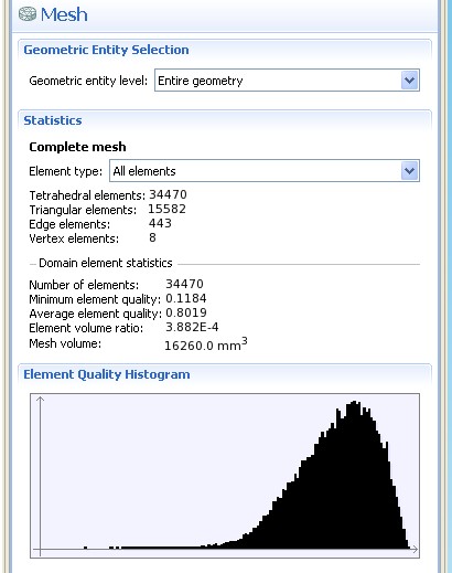

When it comes to the mesh itself, I do not get any domain errors. Perhaps I just don't know where to look but when I right click for mesh statistics, things seem ok.
See image for mesh statistics I see.
I also included the file I have been messing with. Done with ver 4.2.0.187 (the latest).
I find this problem interesting because, while I may not understand it all, just the fact that you are getting different result for the mesh piques my curiosity. You will have to resolve the file because I deleted all of the solutions.

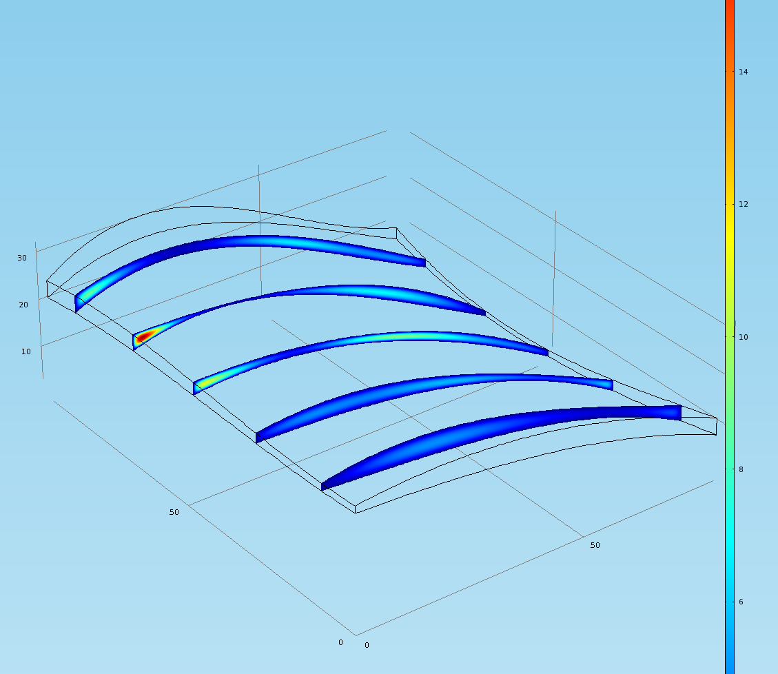

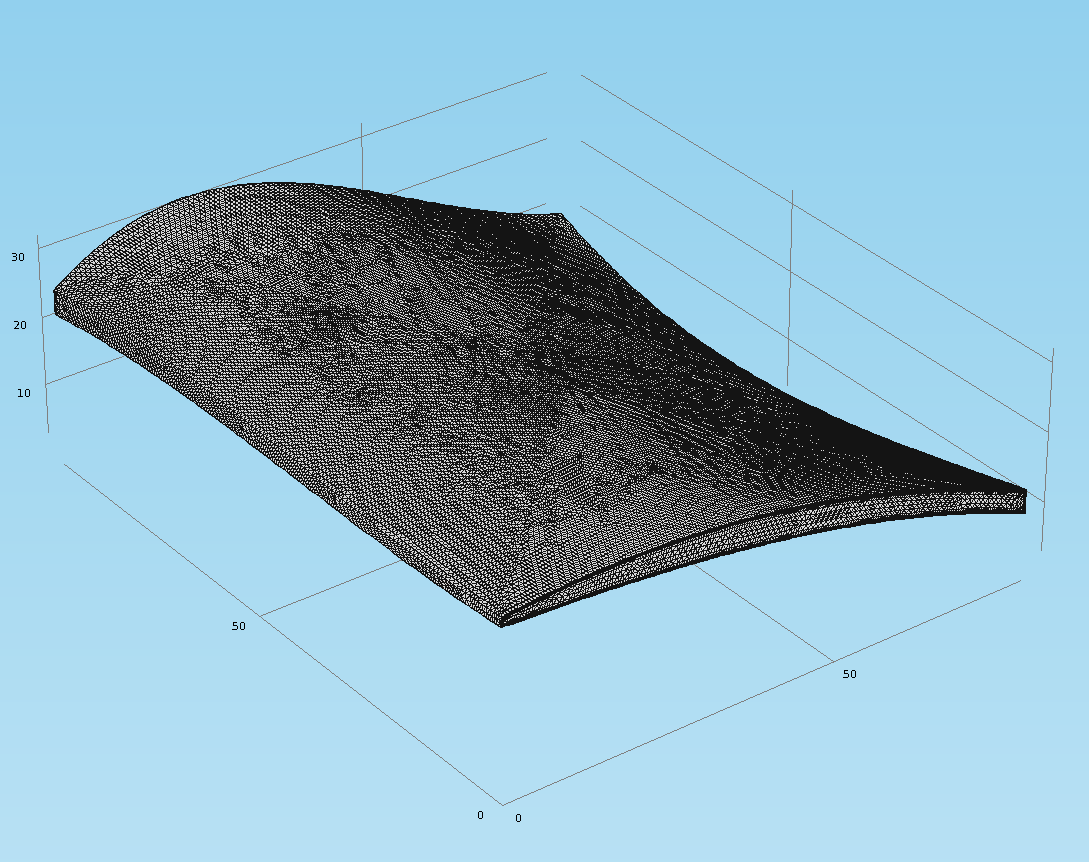

I cannot send you the model file with all the data because it is too large. However, I can send you the model with mesh, solution, and history reset which makes a smaller file size. I am attaching pictures of the mesh and solution to show what you should get. then I started to create the more detailed geomety (increase knots and decrease residual criteria), you can then see the details in the geometry show up. This will require a much more detail mesh. You will need a very large computer to capture all this detail. You elements will need to be very small. You can see how many elements you need for the smoother representation. It works very well, but your data contains a lot of detail that requires detailed elements.
I could not e-mail the 2nd model to you because it is too large.
I cannot send you the model file with all the data because it is too large. However, I can send you the model with mesh, solution, and history reset which makes a smaller file size. I am attaching pictures of the mesh and solution to show what you should get. then I started to create the more detailed geomety (increase knots and decrease residual criteria), you can then see the details in the geometry show up. This will require a much more detail mesh. You will need a very large computer to capture all this detail. You elements will need to be very small. You can see how many elements you need for the smoother representation. It works very well, but your data contains a lot of detail that requires detailed elements. I could not e-mail the 2nd model to you because it is too large.
