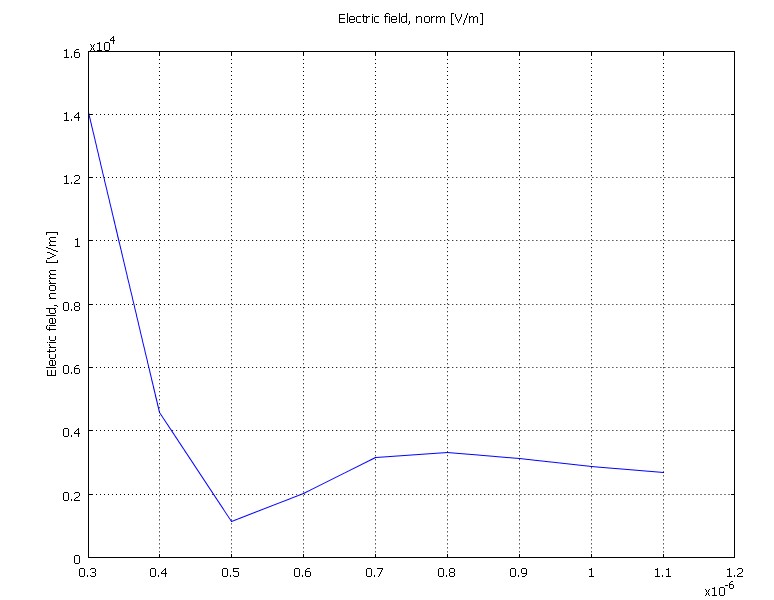

I've got exactly the same problem - I'm trying to model nanostructures and also get the peak for lower wavelengths. I tried doing the calculation without anything in my box and get the same peaks...either we are doing something wrong or there is a bug in Comsol.

Hi! I've got exactly the same problem - I'm trying to model nanostructures and also get the peak for lower wavelengths. I tried doing the calculation without anything in my box and get the same peaks...either we are doing something wrong or there is a bug in Comsol. By the way, the model which was referred to has been taken off the model exchange a while ago. I was first looking for it 2 weeks ago, without success. Regards, Martina

I have been playing around with the size of the PMLs as well as using well-defined ports instead of automatic plane wave excitation, and I always get the same initial peak for low wavelengths, with or without object in my "box" (see the attached Strangespectrum.jpg). For the attached model, plotting the near field spectrum at point (0,0) results in another peak at higher wavelengths, which is the one I would expect, I think. But I cannot think of any explanation as to the first peak....

Hi! I have been playing around with the size of the PMLs as well as using well-defined ports instead of automatic plane wave excitation, and I always get the same initial peak for low wavelengths, with or without object in my "box" (see the attached Strangespectrum.jpg). For the attached model, plotting the near field spectrum at point (0,0) results in another peak at higher wavelengths, which is the one I would expect, I think. But I cannot think of any explanation as to the first peak.... Kind regards, Martina
