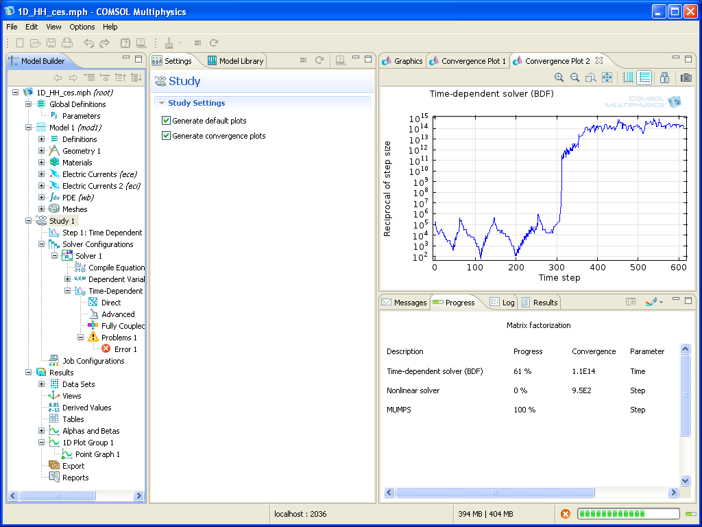

I have the same general symptoms as above: Time-Dependent solution proceeds fine for some time. Then, all of a sudden, the "Reciprocal of step size" on the convergence plot goes to 10^14 and stays there. (See attached convergence plot.)

• The behaviour of trying to terminate the process (as it's obviously not making much progress towards terminating, if it goes in time steps of length 10^-14) is (whether I press the round red button with a white cross on the status bar, OR use the Stop buttons on the Progress tab) that the convergence plot accelerates (!) and so does the activity in the Progress tab, while CPU activity goes to zero on all but one CPUs. I'm interpreting this as a bug where it's trying to process results coming in from the server after I cancelled the simulation i.e. I don't need the results.
• See the convergence plot attached.
Note that, as with the others, the simulation runs acceptably for about 100 ms. I am simulating neurons, and the neuron spikes a couple of times, and everything is fine. Suddenly we see this problem. It's not related to any features of the dependent variables or their gradients — it happens away from sharp transitions in any of them, as I can see if I plot "Results While Solving".
My question is: how can I find out which of the dependent variables (I have 4) fails the error test (which is what must be driving the time step to very small)?

Update: I've noticed that, however I set the maximum step size for Strict BDF, the problem always occurs at solver step 300. This could be at 10 ms into the simulation, 50 ms, 100 ms — this depends on the maximum step size setting. So it definitely does not matter what the values of the dependent variables are at the time that it happens — these are different at the different times into the simulation. The simulation runs its normal course. The error always occurs at iteration 300.
• This happens in stand-alone Comsol, as well as running in client+server mode.
• Not a memory issue: Comsol is using under 400 MB, and there are 2+ GB of system memory available if it wanted.
This affects only the BDF solver. Switching to Generalised Alpha avoids the problem behaviour.
