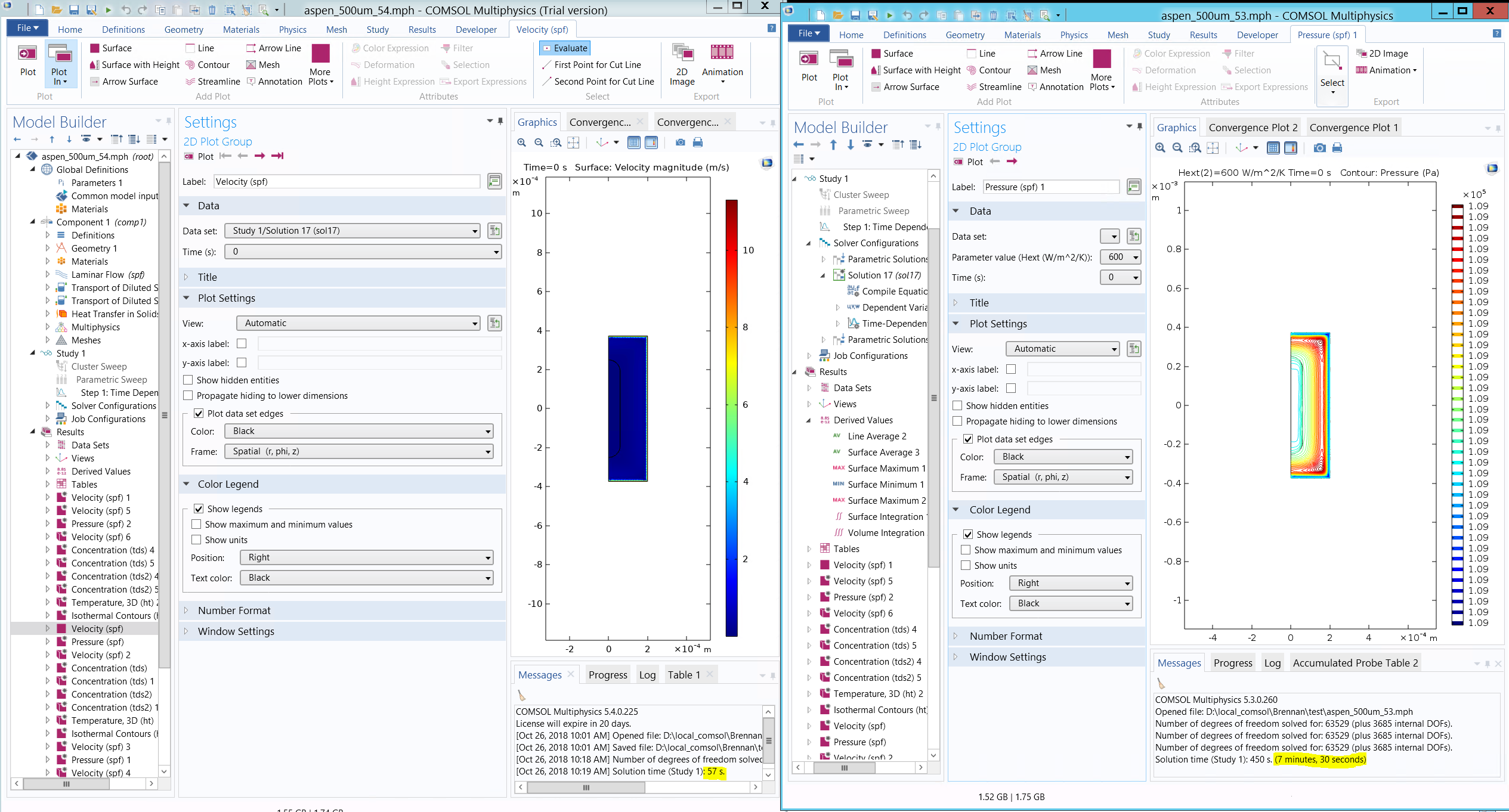

COMSOL 5.4 is 7x faster than 5.3 on our Windows based machine with Intel processors. I benchmarked the two versions with the same simulation.
CFD solving Navier stokes compressible flow, chemical reactions, heat transfer, and porous media transport.
I can't decide if I am excited that the new version is so fast, or mad that 5.3 was so terrible.

I think that we should be happy about the performance improvement. It was not an easy thing for us to fix.
The reason for the dramatic improvement is that we are no longer using Windows' built in memory allocator for computers with more than 8 cores. Instead, we are using a scalable memory allocator adapted for modern computers with many cores and several CPU sockets. The new memory allocator uses slightly more memory than the one included in Windows' but yields better performance, as you pointed out.
Best Regards, Ed Fontes COMSOL

I'm sure Ed has more to say on this, but be sure to go to preferences/ Multicore and Cluster Computing / Memory allocator set to "Optimized for Multicore".
BP
