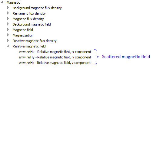

I am solving light scattering problems by nanostructures, along the same lines as the Au sphere demo. Is there a simple way to obtain a plot of the scattered H field in the same way as the scattered electric one?

There are predefined variables for the scattered magnetic field, as shown in the attached image.
Sergei
Miguel, There are predefined variables for the scattered magnetic field, as shown in the attached image. Regards, Sergei

Thank you very much, I had missed that!
