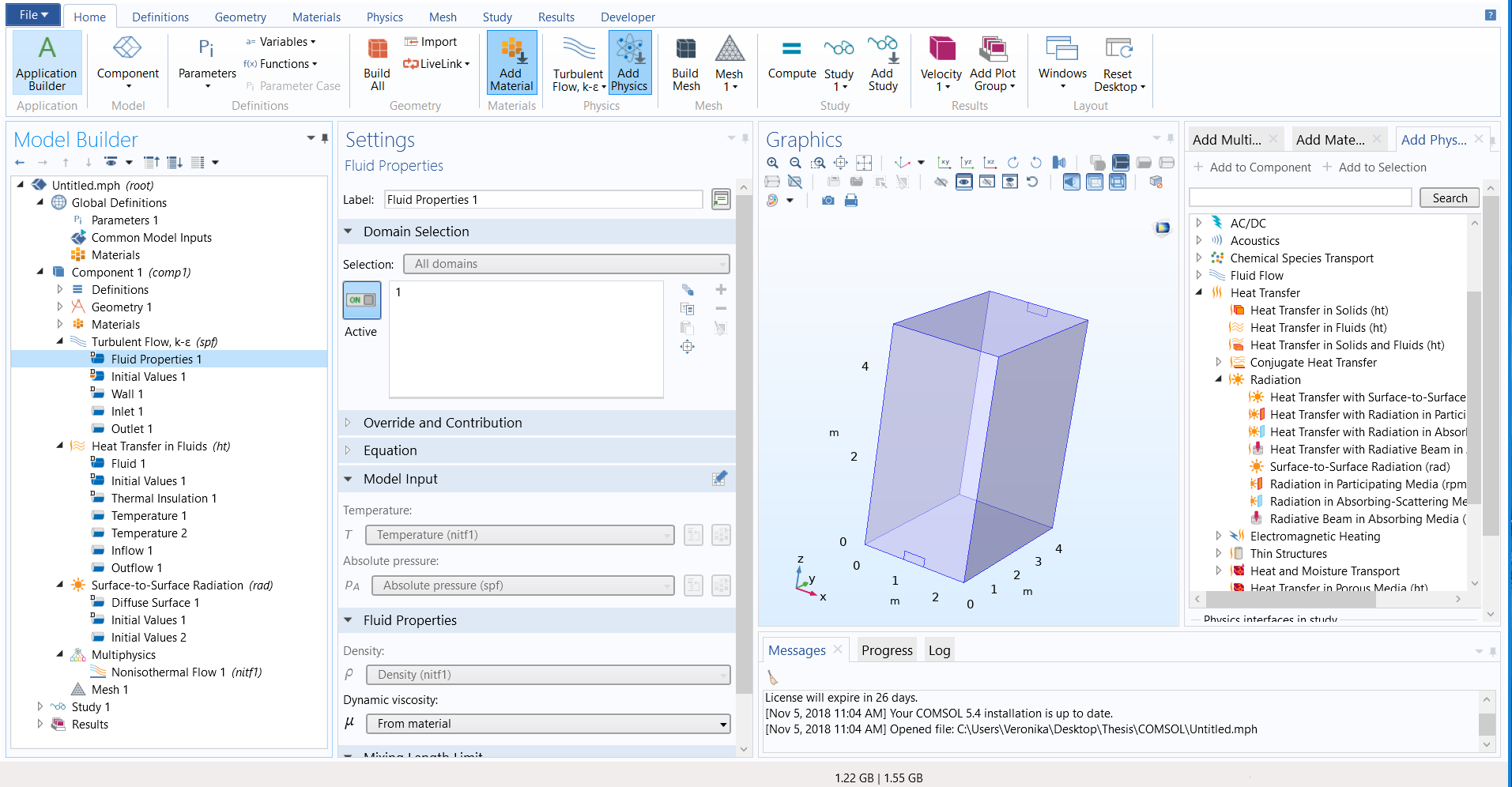

Hi there, I am trying to build up model of the room with displacement ventilation in combination with underfloor heating (adding window and solar radiation later on). Physics like Turbulent flow (velocity inlet, presuure outlet), Heat transfer in fluids, and surface to surface radiation and multiphysics-Nonisothermal flow are used. I would like to simplified model of floor heating as a surface with specific surface temperature, however correct radiation must be applied. I am wondering whether Physics-Radiation-Surface-to-surface-radiation or Physics-Heat transfer with surface to surface radiation is correct in order to include conduction, converction and radiation in the model? How can I include solar radiation?
