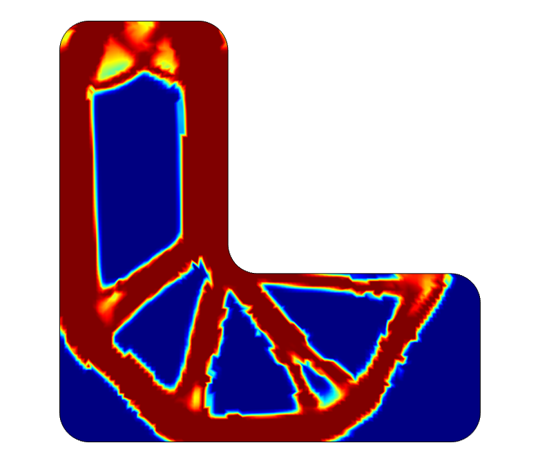

I am using mphplot to display contour plots within Matlab using the color table "Rainbow". The resolution of the resultant figure is really low compared wth how it looks within Comsol Multiphysics. I tried to look for any properties I could change to fix it but no luck so far.
Does anyone know any solution to this problem?
What I am planning to do right now is either: - Extract the plot from Comsol Muliphysics as png for example then displaying it in Matlab hoping it would have a better resolution. - Extract the raw plot data (as in a spreadsheet of values for example) from COMSOL Multiphysics then plot it using Matlab itself.

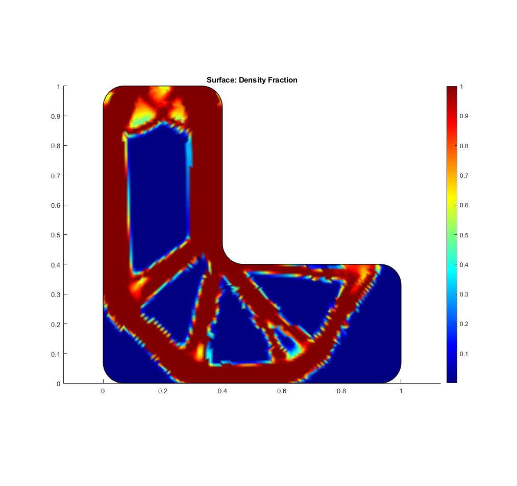

Hi Lars,
Thanks for your reply. I have attached two pngs, one through mphplot from Matlab, and the other one directly from Comsol Multiphysics. You can see the difference in the resolution of the image, it feels like mphplot dilutes the data before sending it to Matlab. Your input is highly appreciated.
Thanks, Mohamed Abdelhamid
Hi Lars, Thanks for your reply. I have attached two pngs, one through mphplot from Matlab, and the other one directly from Comsol Multiphysics. You can see the difference in the resolution of the image, it feels like mphplot dilutes the data before sending it to Matlab. Your input is highly appreciated. Thanks, Mohamed Abdelhamid

Try this: mphplot(model, 'pg2', 'indexedcolors', 'on')
Note: The indexedcolors property is experimental, undocumented and unsupported. It may disappear in a future release of Comsol.

Hi Lars,
Sorry for the delayed reply. I tried your suggestion but no improvement. I discarded the importing the figure from COMSOL to MATLAB and simply did it directly in MATLAB and the results were much better.
Thanks again for your help.
