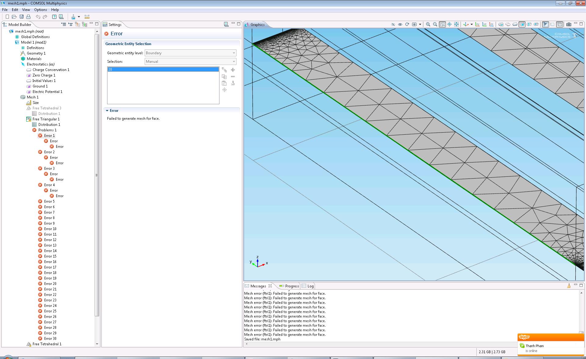

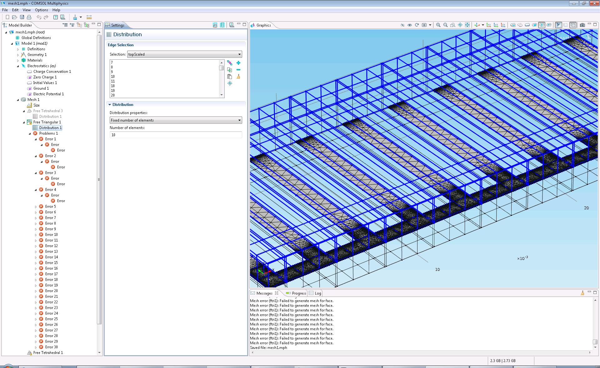

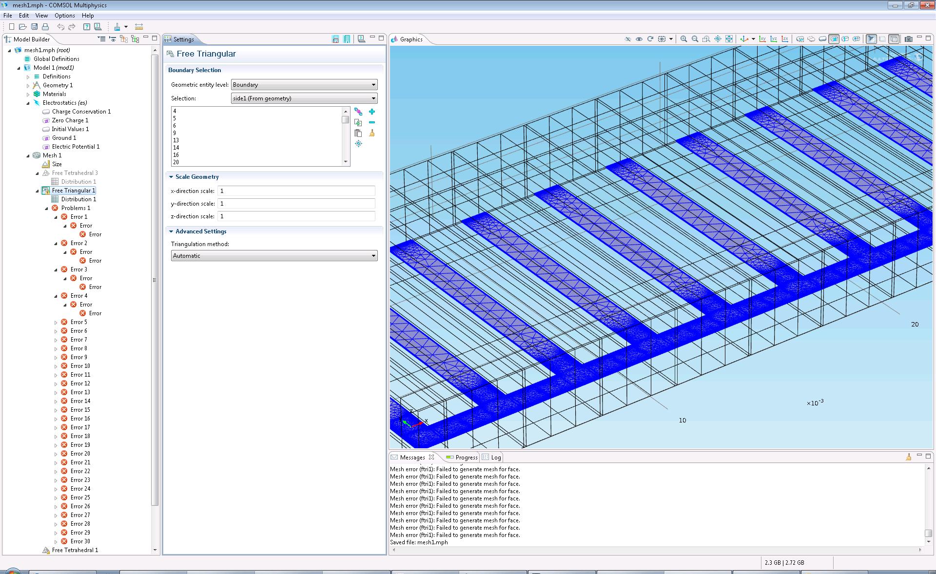

ok i tried following your advice but am not sure if it is correct. the mesh completes to 100% (after about an hour or so) but at the last moment gives errors on several of the thin faces. Ive attached some jpegs showing the mesh settings and errors.
Thanks!
Thanks!
