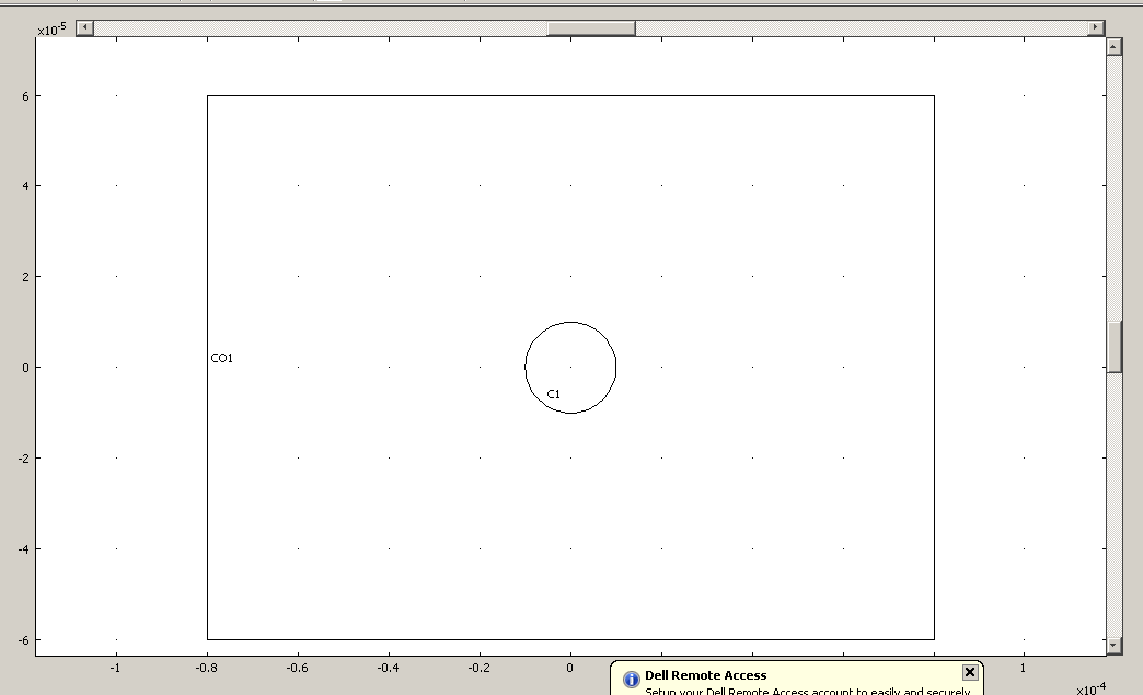

I wish to model a muscle tissue (solid domain) which contains a capillary blood vessel (fluid domain). I’m not interested in the blood flow.
The geometry is in the attached file.

Well, actually I have made some progress since my message was posted. I’ve realized I can change the thickness of the cross section: I’ve changed it to 150 ?m, so now it fits better with my model dimensions (160 ?m *120 ?m). After changing the thickness I found it logical to use the blood pressure value…
