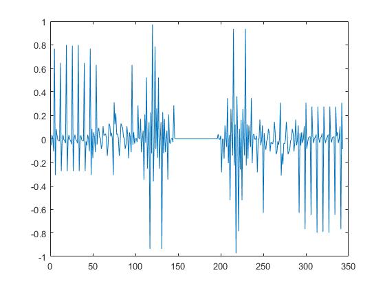

                                                    Thank you for your detailed reply
You are right about a waveguide where there is indeed an effective K vector but there is not expectation for a big change so they will not be vertical at all.
But in a simple case like the file I was uploading would expect that at least there will be symmetry around the center of the box (it isn't even a waveguide, just a box) and in the plane Z = 0 when the light progress direction is X indeed they are vertical and even on the sides of the box, but in the rest of the box they are not vertical (the dot product values are close to 1) that seems a little strange.
thanks again

                                                    OK, I just downloaded your file.  I don't have the wave-optics module, but I have the RF module.
I noticed the following:
- You have a driving boundary condition that I don't understand:
E0z = E0(w0/w)exp(-(r/w)^2)exp(-i(kxx+kzz+(kzz^2)/(2R)-phi))
I presume you trying to launch some kind of shaped-beam or something.  In any case, that doesn't look like a waveguide mode to me.
- Only one of the walls of your box is apparently a conductor.  That is to say, that is what I see when I open the file.  You have one driven wall, 4 scattering-condition walls, and one conducting wall opposite the driven wall.  That's not a waveguide.  It's a conducting plate illuminated by a wave with a seemingly-strange field distribution.
Unless what I saw was caused by me not having the right module, then the above issues are big contributors to your problem.  Check and re-check your boundary conditions carefully.  Oh, and for the field-driven surface, you also might want to consider using a waveguide port boundary condition with a specified mode.  Good luck.
1.  You have a driving boundary condition that I don't understand:
E0z = E0*(w0/w)*exp(-(r/w)^2)*exp(-i*(kx*x+kz*z+(kz*z^2)/(2*R)-phi))
2.  Only one of the walls of your box is apparently a conductor.  That is to say, that is what I see when I open the file.  You have one driven wall, 4 scattering-condition walls, and one conducting wall opposite the driven wall.  That's not a waveguide.  It's a conducting plate illuminated by a wave with a seemingly-strange field distribution.
