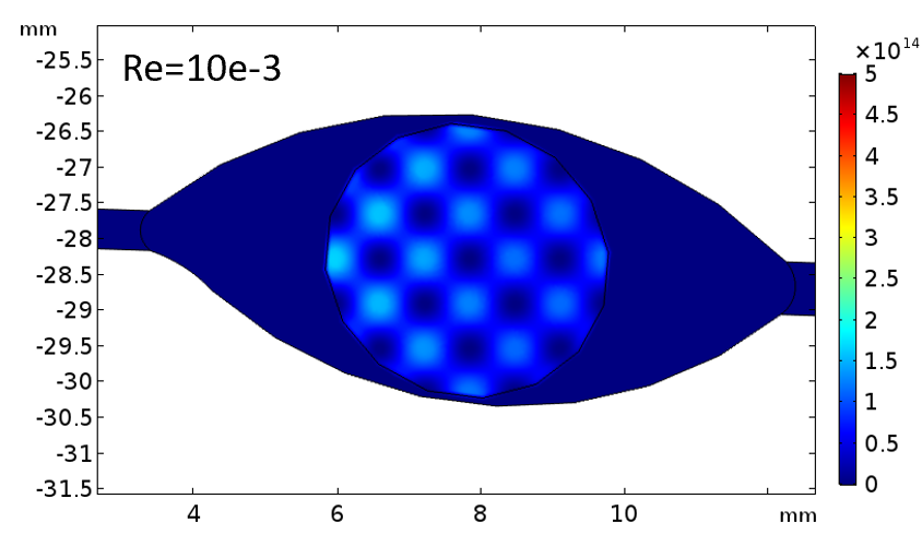

Hi Jeff
Thanks alot for your reply Jeff, and sorry for the long delay. For anyone looking this up later, i did find my issue. Because my model was i only a few mm scale, my sine-cosine wave was too large to give an impact on my initial concentrations. Increasing the frequency of the sine-cosine plane with around 10^3 fixed my problem.
My initial condition thus ended up being
Cx0+Cx0sin(1000x)cos(1000y),
resulting in a good nonhomogenous initial condition. I have included an image for anyone looking this up in the future.
Hi Jeff
Cx0+Cx0*sin(1000x)*cos(1000y),
