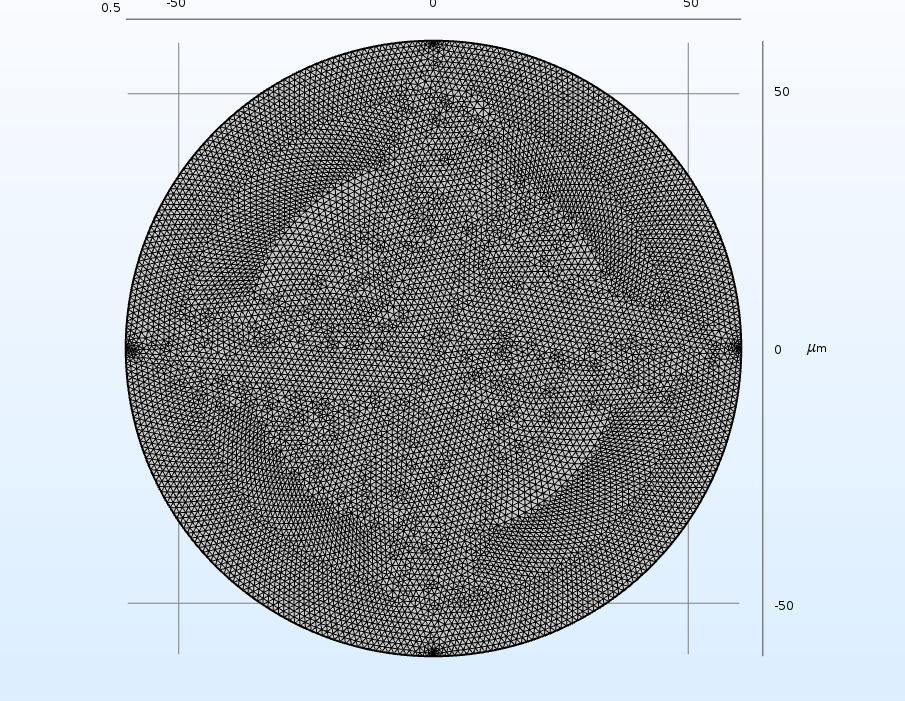

Hi All, When I draw a simple cylinder it has edges such that it looks like the circular face is made of four quadrants. Also when I mesh the structure since they look like edges, the meshing is finer around them. Do I have to have the edges for reasons I don't know ? I would like to have a uniform mesh if possible.

This old thread should help. In addition, since your goal is to generate a uniform mesh, another approach you could take is to mesh one of the end surfaces of the cylinder and then sweeping that mesh through the cylinder. There is a very good video on meshing in the Learning Center: it is here .

Dear Jeff, Thank you so much for pointing me in the right direction. It is difficult to filter through old entries and find useful ones immediately. As it was mentioned by several different users in the old thread, the edges disappear by "Ignore Edges" in Geometry. Also depending on the fineness and aspect ratio of the cylinder or individual cylinders if you have a stack of them, the edge of meshes may coincide to form a line on the side wall –which I thought I would share.
