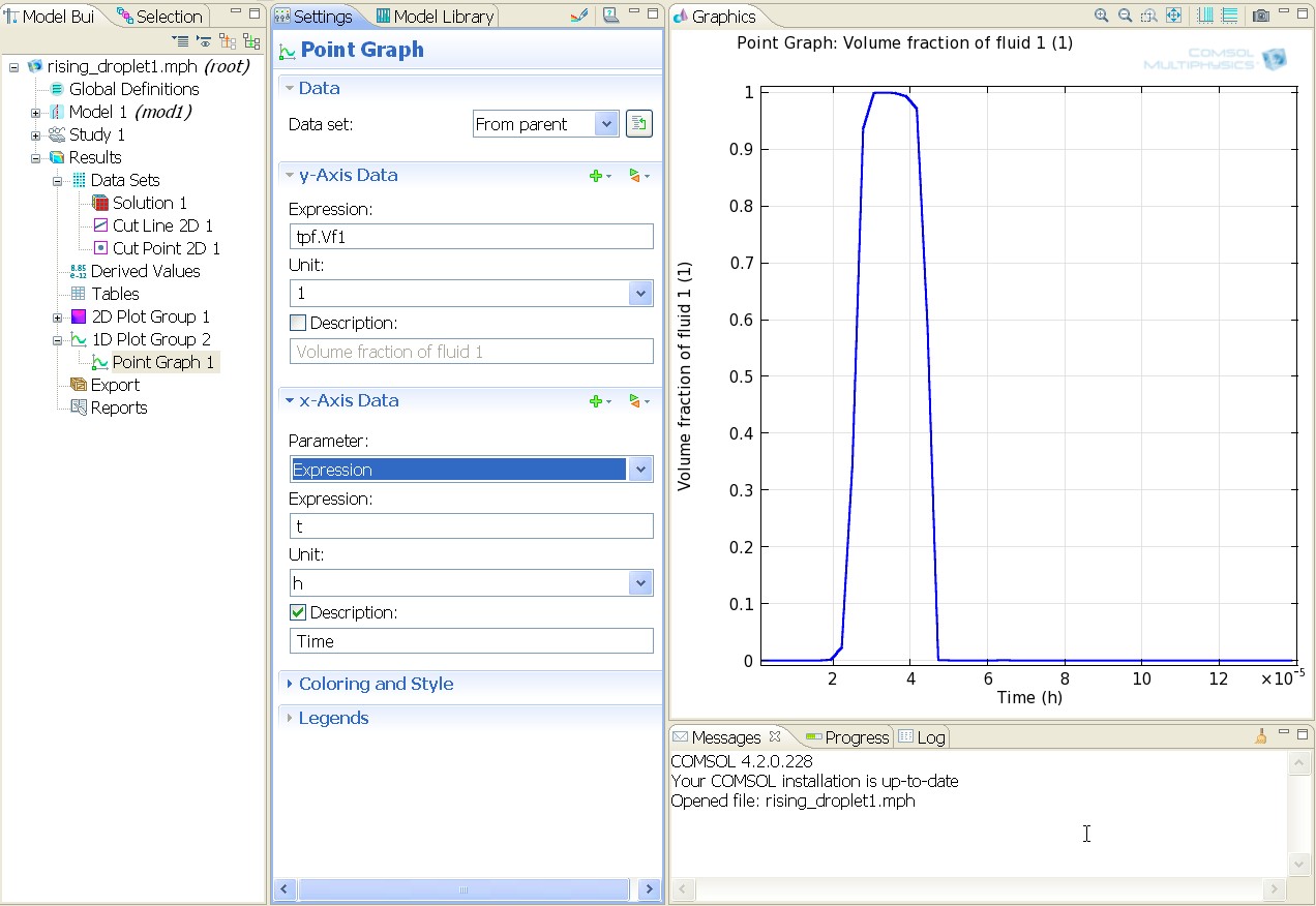

My problem is that I want to change time unit in second (by default in Comsol) to hour, day in the result graphic, because my model result graphic display the testing assuming time about a week, a month... in the nature but now it still displays in second for a week (=60*60*24*7 (seconds)) or a month...

I hope that the attached picture answers your question.
Hi, I hope that the attached picture answers your question.

I suggest a simple solution.
Use the expression for time t/(24*60*60) for a day... and so on.
Change the axis label to day.
I suggest a simple solution. Use the expression for time t/(24*60*60) for a day... and so on. Change the axis label to day.

Thank you for your answers. I did with your way and got it well.
