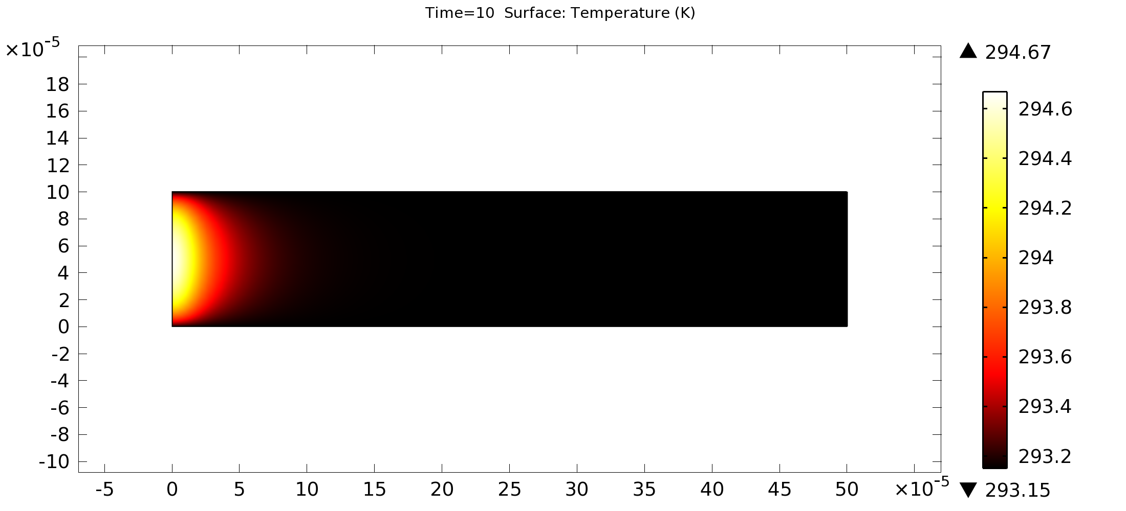

p.s. I get a distribution of the temperature but it doesn't change with time. Temperature distribution is like a Gaussian distribution. find attached.
From the experiment I know that temperature should gradually rise then it becomes constant after several seconds.
