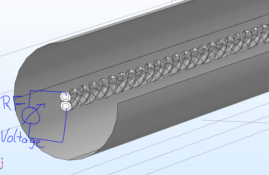

I'm new to COMSOL. In the Tutorials I cannot find any example for the usage of the Lumped Port boundary condition as I need to (I might have missed some), so I decided to pulish my question here. I'm trying to simulate a twisted cable with two conductors (surrounded by insulators) like in the screenshot below. I want to add an alternating current with high frequency and I want to calculate the impedance of the cable and the radiation it emmits. I would prefer the transient solver if possible. Thanks for your answers in advance.

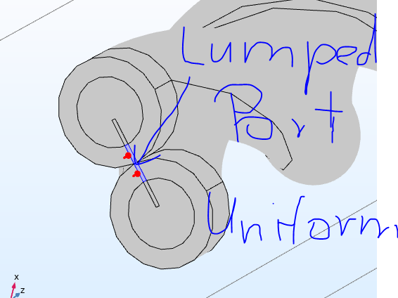

I now wanted to calculate the S-parameter of the structure, so I think, I have to use freqency mode. If I do so like in the tutorial rf_coil like mentioned by Mr.Kaiser LumpedPort/Uniform/Cable/on with some additional surface (see picture) I had to make to use it the same way, I see that most power is reflected back to the source and hardly anything leaves the other side of the cable (there is a second identical but passive port). The impedances of the ports are matched to the cable impedance. I think the reflections occur, because the boundary condition doesn't fit right. Although I did a lot of tutorials, I can find nothing that fits better. Please can you tell me what concrete port and what concrete setting is best, so I have no reflections at the port?

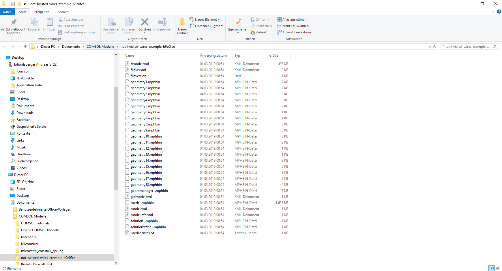

I've just noticed, that I cannot open your file. When I download it I see that it is a zip archieve. I extract it and there are only filetypes I cannot open with COMSOL.
Best Regards Andreas Erhardsberger
Andreas, just rename it to .mph

Sorry Edgar, but what file? I see a list of 29 files.
Rename the .zip file to a .mph file. Actually Comsol model files are zip archives.

no thanks it works for me now. I had just to change .zip to .mph. I am currently thinking about it.

Thank you. I didn't think of that way to calculate the impedance. I think it's a very efficient way in regard of computation time. I may have not said it corrctly, but I wanted to calculate the Insertion Loss of the cable for a certain lenth. So I need a second port to get a S21 Parameter. I insered it on the other side of the cable and I get I think sensible values of S11=-13dB and S21=-0.23dB, so almost no reflections. This was after I matched the port impedances to the impedance of the cable. I realize that it is very crucial to use Transition Boundary Condition here. If I use Perfect Electric Conductor on this surfaces instead, like I did before, nearly all power is reflected back to port1. Why is this the case?
I don't know if this is going to be a satisfying answer but one guess (and really just a guess) could be numerical stability in the simulator due to having a boundary condition that is lossy. The PEC is lossless and maybe there is just some noise there corrupting the results.
