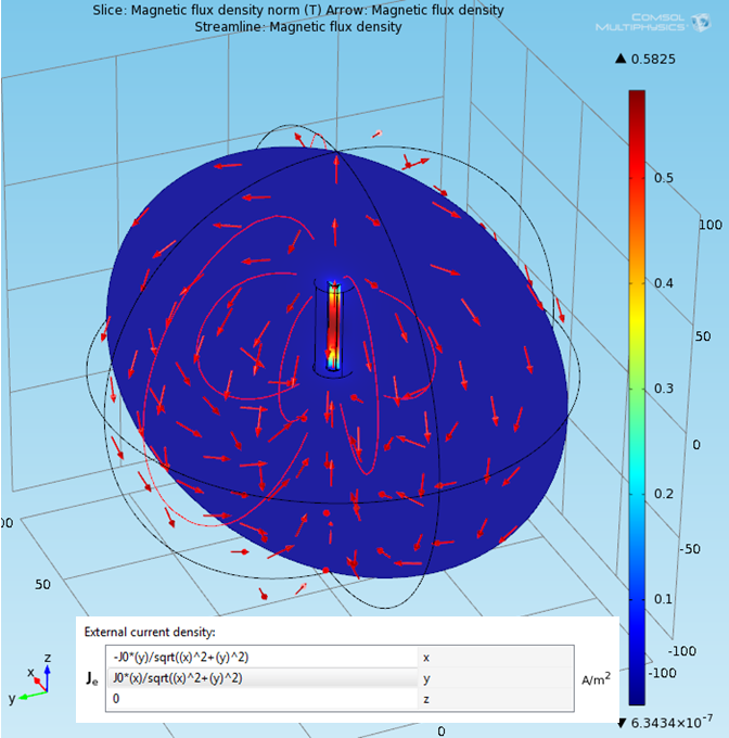

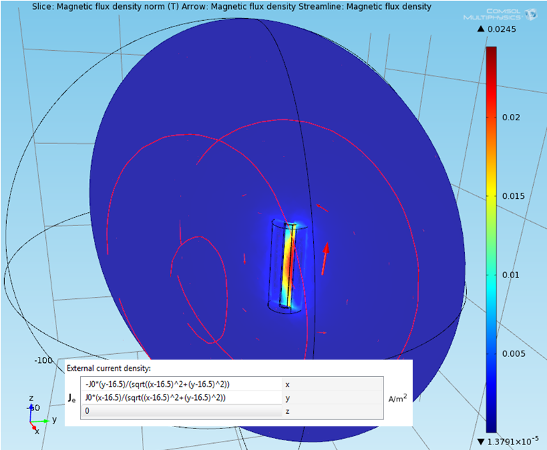

Posted: 1 decade ago 30.09.2011, 18:03 MESZ
Hi, Ivar,
I still can't get it working. I'm just trying to simulate a simple solenoid. When it's place in the center, things work out fine. I use the current density equation that's included in the Helmholtz example in model library. But when I place the coil at (16.5, 16.5, 0) and in the equation, I shift the equation by 16.5 (see images attached), I get nonsensical results. I'd really appreciate your help. Also if there's a way to redefine the coordinate when setting up boundary conditions, it'll make things much easier. Thank you very much!
Charles
Hi, Ivar, I still can't get it working. I'm just trying to simulate a simple solenoid. When it's place in the center, things work out fine. I use the current density equation that's included in the Helmholtz example in model library. But when I place the coil at (16.5, 16.5, 0) and in the equation, I shift the equation by 16.5 (see images attached), I get nonsensical results. I'd really appreciate your help. Also if there's a way to redefine the coordinate when setting up boundary conditions, it'll make things much easier. Thank you very much! -- Charles
