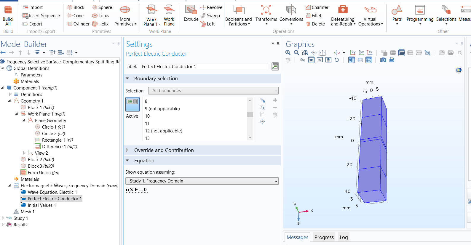

How to do the italized below? there should be a rigorous step before going to perfect electric conductor E L E C T ROMA G N E T I C WAVE S , F RE Q U E N C Y D O M A IN ( EMW) Set up the physics. First, define physics-controlled mesh maximum element size. Use Floquet-periodic conditions on all side boundaries. Perfect Electric Conductor 2 1 In the Model Builder window, right-click Electromagnetic Waves, Frequency Domain (emw) and choose Perfect Electric Conductor. 2 Select Boundary 12 only. Periodic Condition 1 1 Right-click Electromagnetic Waves, Frequency Domain (emw) and choose Periodic Condition.

I understand that you are working on this example model of a frequency selective surface. The italicized text is just a summary of what the step-by-step instructions that follow tell you how to do.
