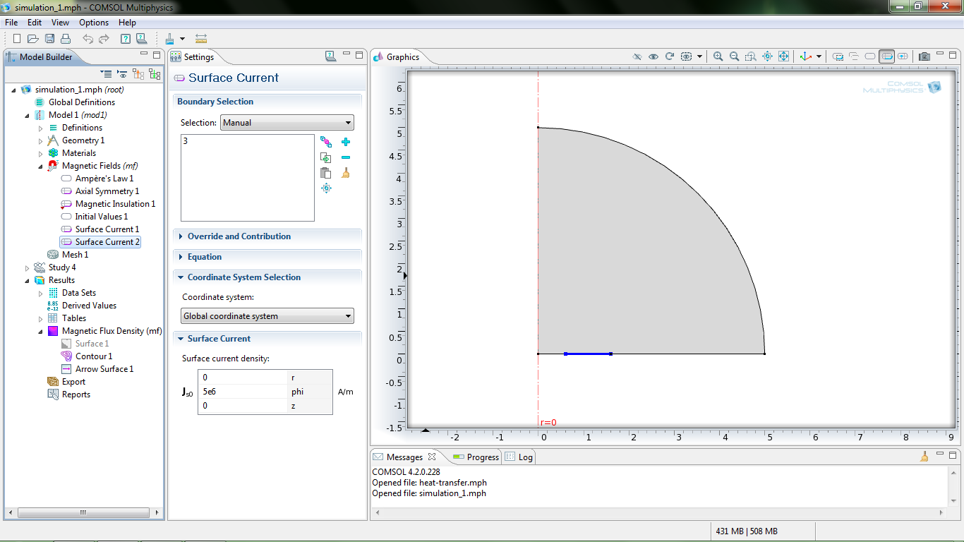

I am currently doing a simulation on Comsol 4.2 on a 2D magnetic field representation.
My question is regarding the input value of current density within magnetic fields module.
I would have expected that the current density unit would be A/m2 but it is written A/m which is basically a unit for magnetic fields.(see attached screen shot)
Does anybody has a clue?
Thanks a lot,
Guillaume

Guillaume,
on your image it looks like you define a surface current on a boundary. This is why you have the unit A/m. The total current in this case is this linear current density times the length of the boundary in r-direction (and/or z-direction).
If you define azimuthal current density on a domain (cross section) you will get the unit A/m2.

Dear Edgar,
Thanks for explanation. The boundary on which I applied the current is actually a very thin conductive surface(1um thick); that is why I took it as a boundary.
In the reality, I have a cross-sectional area of 50um2 which is very tiny.
The biggest value allowed in this crosssection is 5e6 A/m2. Shall I put 5e6 A/m in my simulation?

Posted: 1 decade ago 04.10.2011, 16:25 MESZ
you should respect units, but in 2D-axi a surface is in fact represented by a loop 2*pi*r*dr where dr is a small element of the boundary(=edge) of length L. Do not forget the 2*pi*r when needed ;)
Furthermore, a "surface current" in 2D-axi is in fact a current on a boundary = edge so you must normalise = divide the current by your thickness to get the surface density.
You say it looks "like a line" but your selection is also a line and not a domain = surface (in 2D-axi) so for me something is not understood (by me or you ? ;)

Thanks for answering.
I know about the fact that a boundary in 2D-axi is actually a loop in 3D
I assumed that the thickness of my coil was almost equal to 0, that's why I took a boundary to model it.
The only thing I missed I guess is to divide the value of 5e6 A/m2 that I have by the thickness of the layer.

Posted: 1 decade ago 04.10.2011, 20:48 MESZ
carefull, if you have a current density [A/m^2], you must multiply it by the thicknes [m] to get the linear current density [A/m]. I was assuming you started from the current [A], that you need to divide by the thickness [m] to get to the line density [A/m] ;)
As I said, with COMSOl it's easy just check your units, systematically

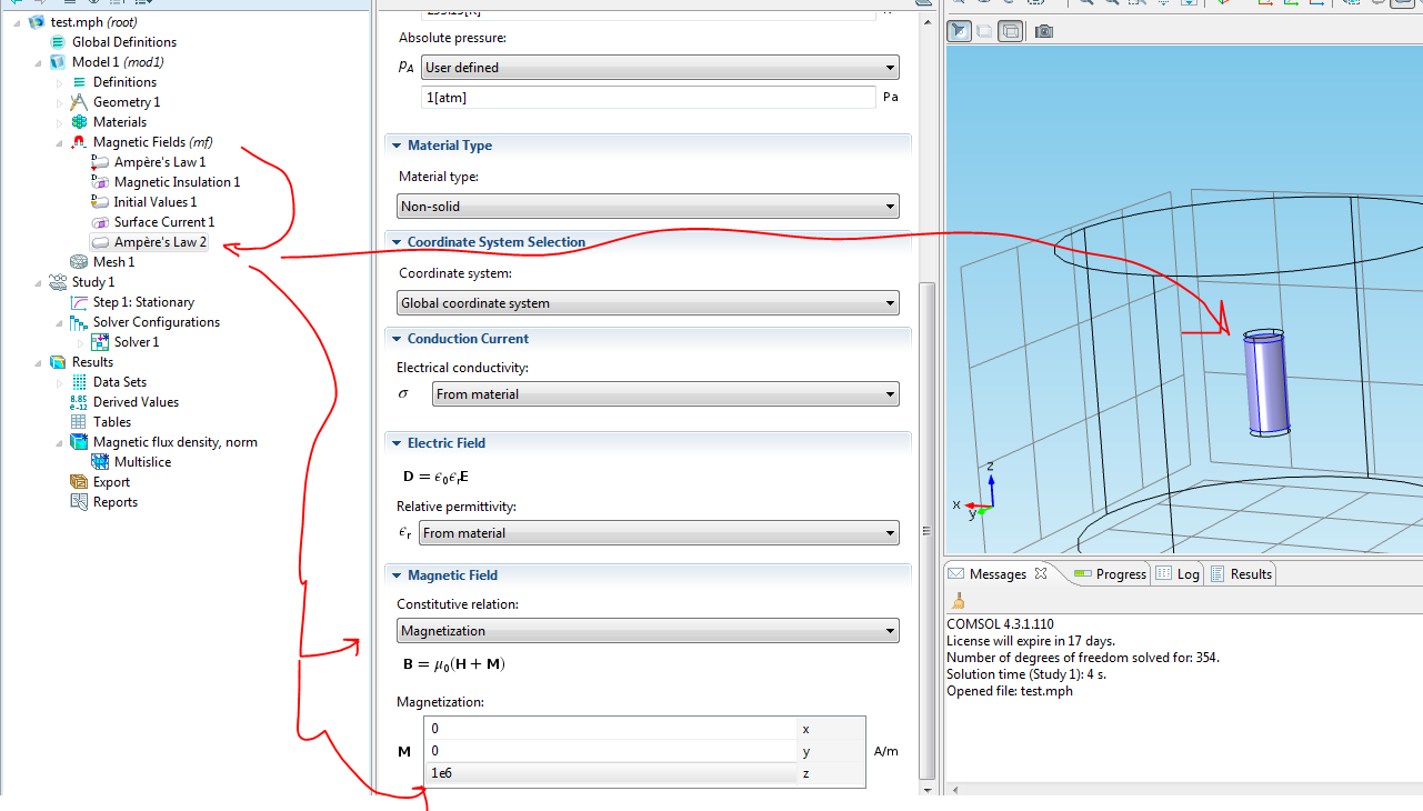

Posted: 1 decade ago 09.10.2012, 14:05 MESZ
I have prepared two samples in 3D. One with surface current density (10turns I=1A) coil of the length 9mm so the surface current density is 10*1/9e-3 [A/m] and another case with real coil.

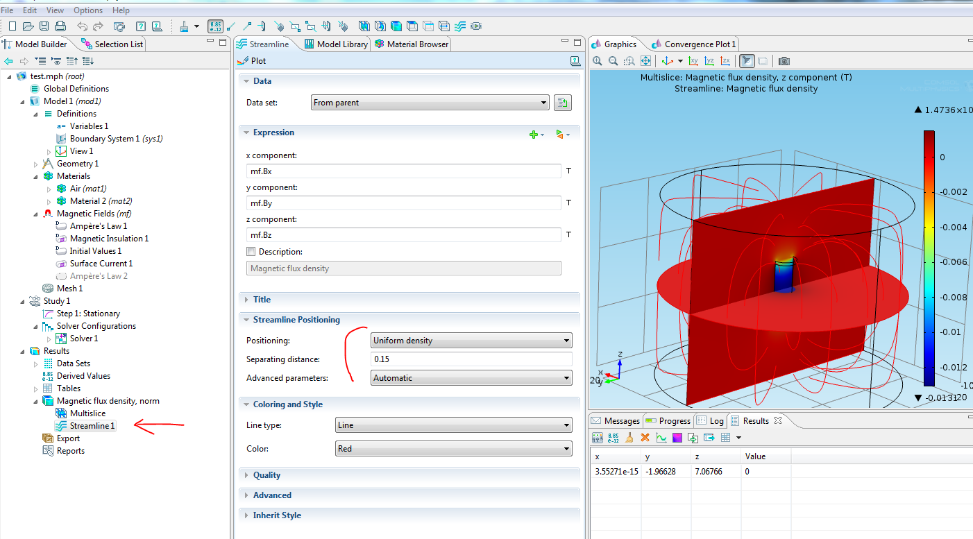

Posted: 1 decade ago 09.10.2012, 21:49 MESZ
your case 2 is strange (add a streamline and look at the magnetic flux lines)
to generate a magnet use the 2nd capture, or your test file, or even the test 2, but add a central cylindrical coordinate system and select the coil + add a domain external current on this cylinder with a cylindrical phi current density of the appropriate value 10*1[A]/Section[m^2]

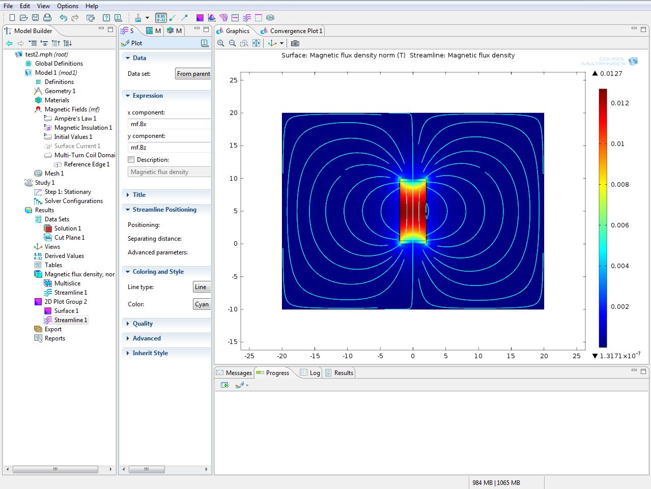

Posted: 1 decade ago 11.10.2012, 12:24 MESZ
I created test cases to check that I understand surface current density definition.
I do not see any problem with test2.mph, stream lines look good.

Posted: 1 decade ago 11.10.2012, 16:23 MESZ
indeed on last image it looks OK ;)
