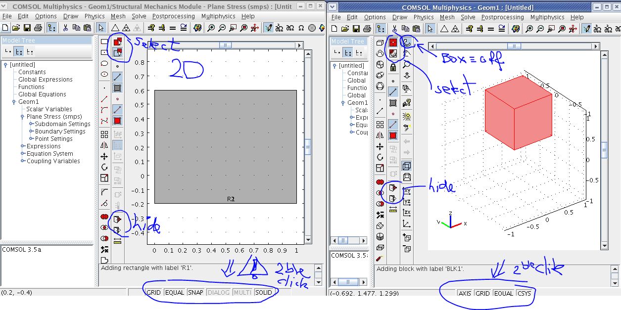

Well as I said just above, in 3D you have the box option it is there, (I needed some tips from support to find it, hadnt read the "what's new" well enough ;) in 3D as by default, "boxing" is off in favour of pan/rotate.
In fact, there are may if these icons, that are rapidly forgotten, but in fact very useful, they are slightly different in 2D and 3D.
Take a look of some of my "often forgotten favorites" on the screen capture attached below, and take a look at the "beginners guide" as I did ;)

I tried to use 'Supress Domains' before, but upon changing to the 'Free mesher' the surpressed domains are "unsurpressed" and everything is shown again. Interestingly, using the 'Hide Selected Object' icon (see Ivar's jpg) did help a lot, as by using this icon to hide domains allowed me to select the desired boundaries (which are the internal boundaries still shown after one domain was hidden). It's not very convenient but it should do until version 4 is released.
