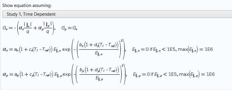

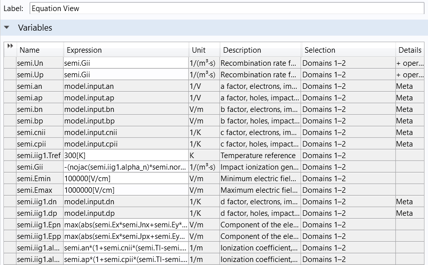

So, for Epx to be equal to zero 0, the only way I see is valX to be a negative number. E.g. "semi.normJn" and "semi.normJp" must be negative, which to me does not make sense. I've tried putting abs() around "semi.normJn" and "semi.normJp" but the error remains. Also, in equation view table in the IIG model, there is an a threshold value for E=1E5, which I couldn't find where it is specified or why (picture attached*). If anyone has any suggestions regarding the nature of this error or information about where and why is E threshold value defind, it would be much appreciated!
