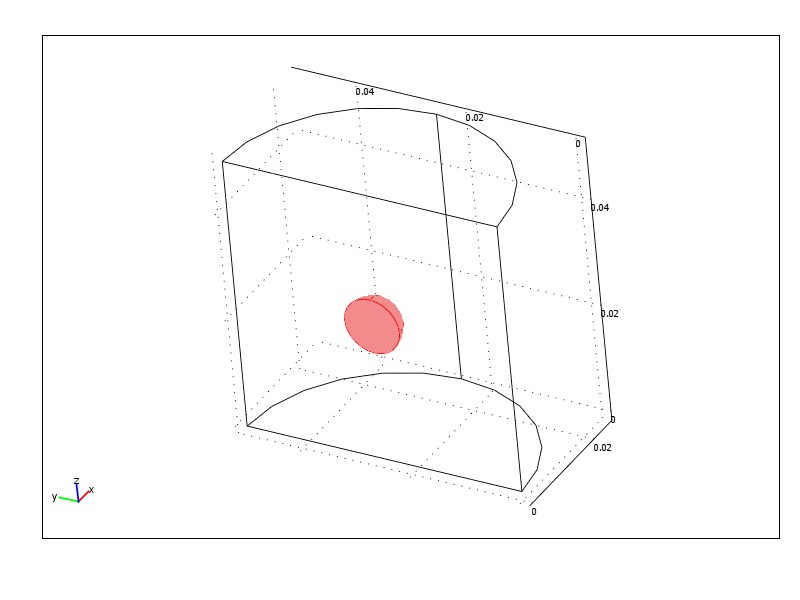

I have attached the picture of my 3D module.

The formula you specified is for axisymmetric volume integration. In 3D you should remove the 2*pi*r term. The reason you get an error is that “r” is not defined in a 3D analysis.

Thanks for the reply, Nagi. I figured out that issue and the model is working fine now.
