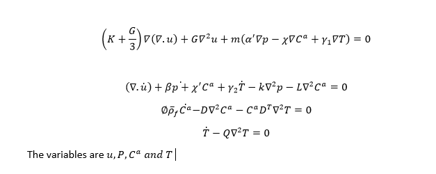

I am trying to model 4 equations. However, when I input the variable u1 in the first equation, and when I try to input same varaible as u1 in the second equation it gives me an error message. I have attached here my sample equations
Hi Jeff, I am trying to model 4 equations. However, when I input the variable u1 in the first equation, and when I try to input same varaible as u1 in the second equation it gives me an error message. I have attached here my sample equations

Hi Adamu,
It would be difficult to say anything intelligent without seeing your mph file. Please post it here, thanks.
