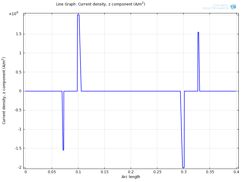

I rechecked my model and the current density-z component plot is attached here. The left two plots corresponds to winding 1(primary) current density, and the right two plots for the winding 2 current density.
In this model I'm trying to model windings covering only 180 degrees of the entire core. Also both the windings are on opposite sides. The core is modeled as two circles making a ring while viewing from top.
From the Jz plot, its clear that the current density varies such that current remains constant. So to my knowledge, I understand that the direction of current seems ok. I appreciate any thoughts from you.

Posted: 1 decade ago 01.11.2011, 09:18 MEZ
well I probbaly do not understand your model, what puzzles me is the graph below I just do not understand hpw you get the Jz current to flow like that with positive on the left side and negative on the right half ring side
My understanding was that it looped around radially with different signes for inneror outer, or that it went in on the inner and "out" on the outer ring.
