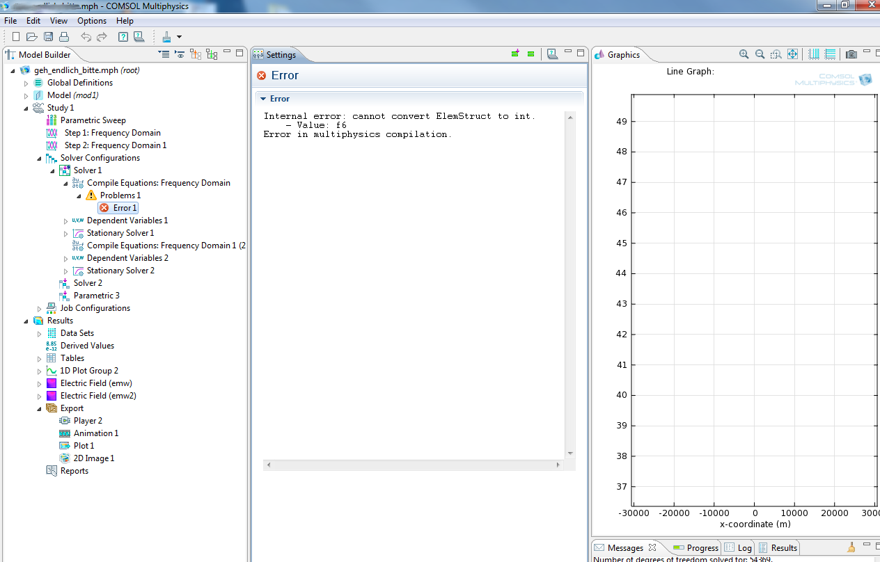

last week I got a new computer (Windows 7 system) and just tried to run my Comsol models and an error occurs.
Whenever I try to run the study I get the following error:
Error in sweep: The following feature has encoutered a problem
- Fearture: Compile Equations: Frequency Domain (sol1/st1)
-Error: Internal error: cannot convert ElemStruct to int.
-Value: f6
Error in multiphysics compilation.
This happens with all my models (all ran well on the old computer which was also Windows 7 and also Comsol 4.2).
But when I start a the same models from a USB device no error occurs.
I attached a sceenshot of the error message if someone is interested.
Could anybody help me with this problem?
Thanks!
Annika
6 Replies Last Post 29.10.2013, 15:42 MEZ
Posted: 1 decade ago 01.11.2011, 14:05 MEZ
With a little more trial and error I finally found the cause for my problem:
my administrator put my actual name as my user name so it included special characters.
And it is not possible to set the path to external functions, if there are special chars included and you'll get my error.
So: new account, different name, everything works fine!
