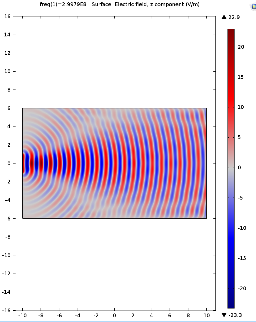

I want to set up a Gaussian wave of 10 GHz. I am not quite sure how to do it. Any advice and suggestions will be highly appreciated.
I have attached file that how it should look like.

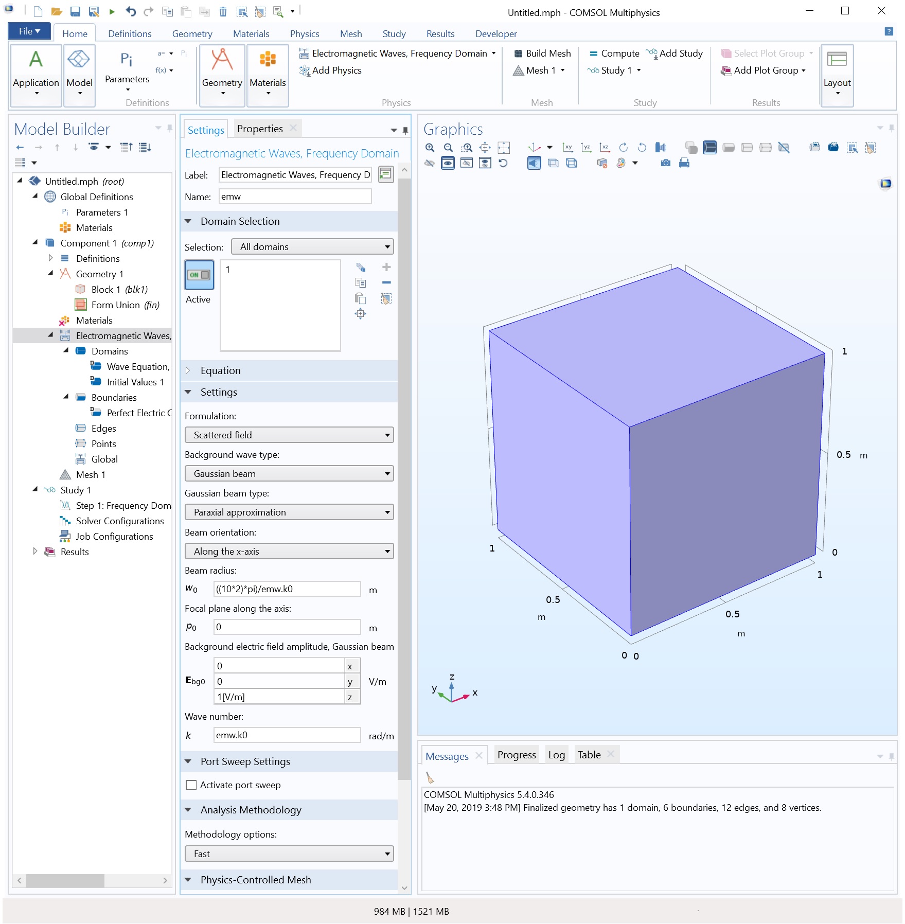

You can set up incident waves with a Gaussian cross-section in the Scattered Waves formulation, in the RF module, fairly easily. See the attached screenshot.

Hi Robert,
Thanks a lot. It works.
Best, Dipankar
Hi Robert, Thanks a lot. It works. Best, Dipankar
