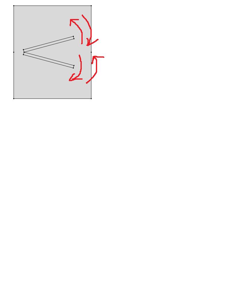

Yes my problem is about a body with two parts rotating in opposite direction and changes direction with respect to time. I want to study the net force experienced by body over a time period of one cycle (or in particular I am interested in finding net displacement of the body after a cycle of flapping).
I could not give rotating fluid domain as the parts are overlapping (please see the attached figure).
My problem is moving these two parts (2d boxes) in semi-circular paths back and forth with respect to time.
Would you please advice how can I achieve this?

OK I get a better grasp of it like that ;)
It's true that you could do as well with only a line instead of the surface for the flap. And I suppose you have a "hinge" it the convergence point of the two flaps there.
Two things that strike me:
1) you do not have a long inlet, not outlet, compared to the diameter, be sure you flow is well developed, or add some length, if you have an inlet velocity?
2) you have a symmetrical design, one could dare a hypothesis that its symmetrical with respect to the horizontal axis, hence start with a simpler case, or ?
To force the flaps to move/rotate, you could perhaps try to add a moment on the hinge side (where the two connect), or you impose the displacement via a coordinate system at the hinge point. you could probably also fix the hinge point and say that the motion forwards or backwards is the travel of the fluid along the horizontal axis, depends where you put your reference frame, on the shore or on the boat (Euler or Lagrange, or a mix ?) (check on Wiki for the definitions) you need then to define correctly the inlet/outlet boundaries, or just free-flow (not sure its in all physics)

I havent had time to goo fully through your model, but I believe you are "overdoing it slightly". You have large deformation engaged on the structural, but your "cast" iron parts will not be severely bend by water I beleive (it might be a COMSOL default but in your case its not requried, it adds alo non-linearity to your model, hence its tougher to simulate).
Then formally, do you need the structure ? if you say only fluid and assume that the "steel" part is infinite rigid, you can remove the structural part and remain with fluid and ALE / deformed geometry physics to simulate the deformation. But this means using different physics. It would make a lighter model that should solve better.
Your point loads, as bolean functions are to close to a Dirac step, you should rather use the built in step() or pulse() functions to smoothen the transitions
You need boundary layers for the mesh on the no-slip flap fluid boundaries.
And I beleive the mesh at the junction point of the two flaps will be very squeezed, it might be an idea to open up the flaps, with a small gap to help the mesh to "topologically survive"
then with all open boundaries (symmetry for the top bottom could probably also do, I suspect that you do not define a pressure value, I would add a p=0 point load on one of the external corners of your fluid volume
