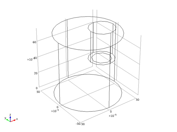

I have a system as follows:
A small cylinder (capillary) is inside the big cylinder (channel). I want to study the effect of capillary on the flow distribution inside the channel. The flow rate in the capillary depends on the pressure maintained at the capillary outlet.
I created two cylinders but I do not know how to join them. I think I need to use contact or identity pairs. But I did not understand them clearly from the user guide.
Currently, I am using difference (big cylinder-capillary, geometry figure attached). Then I use laminar outflow condition at the capillary inlet. The results make sense. My next step is to solve the equations in capillary also. Can somebody help me to connect these two domains.

Hi Ivar,
Thank you very much for your reply. At present, I do not have access to comsol. So I did not try the way you mentioned.
Does "geometry finish union" work differently than the "union" from "Boolean operations" ?
Because I used the "union" from "Boolean operations" . In this case, I could not edit internal boundaries (to specify the capillary walls).
Can you please send me a simple example if you have some time?
Thank you.

In fact, continuity of flux over interior boundaries is my problem. It should be wall bc at the interior boundaries.
May be I am not able to understand something.
Currently I subtracted capillary from the tube and in this case I am able to chose the wall bc. I use laminar outflow bc at the capillary inlet. Results make sense. But someday I may need to solve the physics in capillary also.
[QUOTE] Hi indeed the finish - union is first making an union of all objects, then it analyses the objects and transform them into entities, which are numbered, identified, overlapping objects are split and duplicates removed. Common boundaries are also grouped, as by default there is a continuity of the flux over such boundaries [/QUOTE] In fact, continuity of flux over interior boundaries is my problem. It should be wall bc at the interior boundaries. May be I am not able to understand something. Currently I subtracted capillary from the tube and in this case I am able to chose the wall bc. I use laminar outflow bc at the capillary inlet. Results make sense. But someday I may need to solve the physics in capillary also.
Posted: 1 decade ago 30.11.2011, 17:05 MEZ
you have the "Geometry - Finish Assembly" mode to dedouble all common boundaries, then you can link them with some how brew physics, not necesarily respecting only the continuity. This is what COMSOL does implictely for its internal "thin layer physics"
