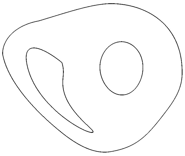

I'm wondering how to define the subdomains for an imported .dxf object. After importing the dxf file to COMSOL, I tried every thing to define the subdomains, But i couldn't find any way.
It consists of 3 closed boundaries , 2 inside the third one. I designed it with photoshop and coverted to .dxf file for COMSOL, using a general image2Dxf converter.
My geometry is supposed to be a closed environment with two holes inside, that I want to define the boundaries as 'Electric Insulation' and place two electrodes inside ...

I have turned on the interior boundaries, but all of the boundary section numbers and the group box are inactive, so that i can not change and regroup the boundaries.
Actually I can't make the COMSOL understand that my environment is a subdomain with two holes inside (jpg file attached). So when it starts meshing it just segments the lines!! and not the area between the closed loops. It's stupid.
I had a very carefull look on the geometery and it seems to be solid enough and has no problem. Actually I couldn't find any software for transforming jpg to .mphbin or .mphtxt , but it seems that the problem is something else

This is common practice when importing DXF files, which often contains the boundaries (edges) of the domain but no information about the solid domains that they enclose. You therefore need to form solids during or after the import before you can use the geometry for analysis (unless it represents a truss, for example). You can do so in two different ways:
- In the Import CAD Data From File dialog box, click "Options" before importing the DXF file. In the CAD Import Options dialog box, click the "Try forming solids" button and then click "OK".
- After the import, with all boundaries (curve objects) selected, click the "Coerce to Solid" button on the Draw toolbar.
In both cases there may be solid domains that, for example, are air domains that will not be part of the computation. You can then click the "Split" button on the Draw toolbar to split large composite solid objects into individual geometry objects for each enclosed subdomain. That makes it possible to delete them or use other CAD tools in COMSOL Multiphysics to further modify the geometry for the finite element analysis.
