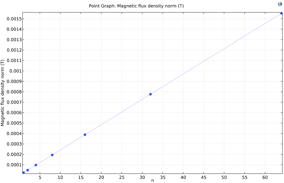

Dear Michael,
     I think you have a problem with the comparison. If you perform a sweep variying number of turns in the "thin solenoid test" you will see the expected behaviour, i.e. B proportional to n (see attacehd fig generated with your model).  You have change the geometry of the solenoid between the 2 cases and that as causing the differences you observe.
     Kind regards,
     Julian
Dear Michael, I think you have a problem with the comparison. If you perform a sweep variying number of turns in the "thin solenoid test" you will see the expected behaviour, i.e. B proportional to n (see attacehd fig generated with your model). You have change the geometry of the solenoid between the 2 cases and that as causing the differences you observe. Kind regards, Julian
